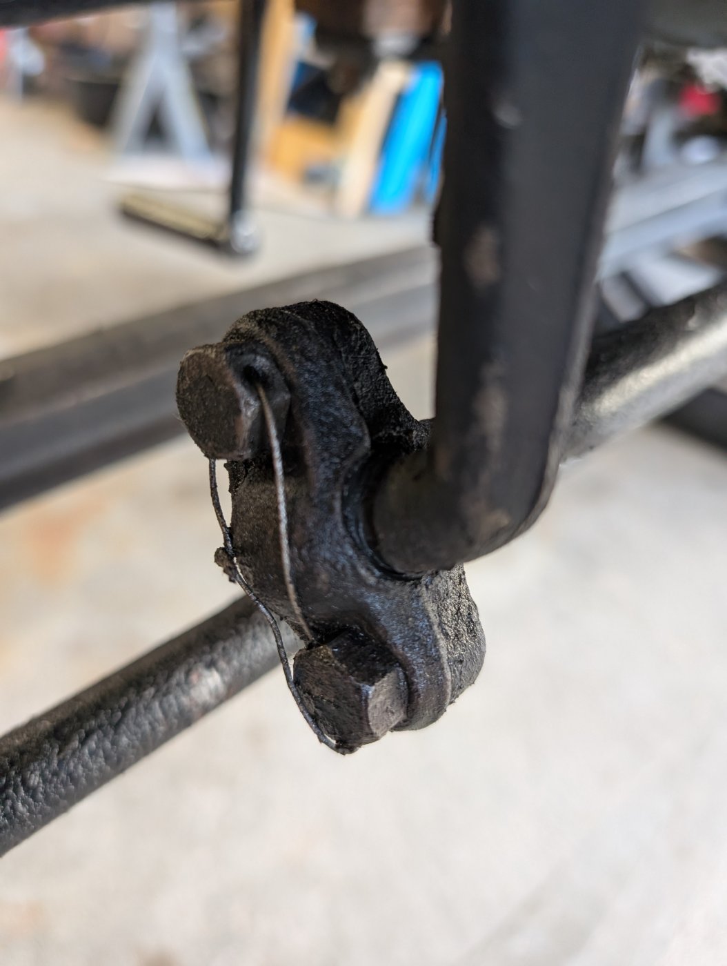

I just noticed that my two T's have different connections at the draglink/pitman arm connection.
Which is correct? Bolts and safety wire, or nut and lock washer?

Neither.
Castle nuts and cotter pins.

Hi Dave, I think what Keith meant was. Bolts long enough to install castle nuts & cotter pin.

Bolts, castle nuts and split pins, just like the pan bolts.

As posted, use bolts, castle nuts and cotter nut to bolt end. The bolts pass into the cap but will thread into the drag link. The nut and cotter keeps bolts in place.
(Anti-rattle spring is accessory)
