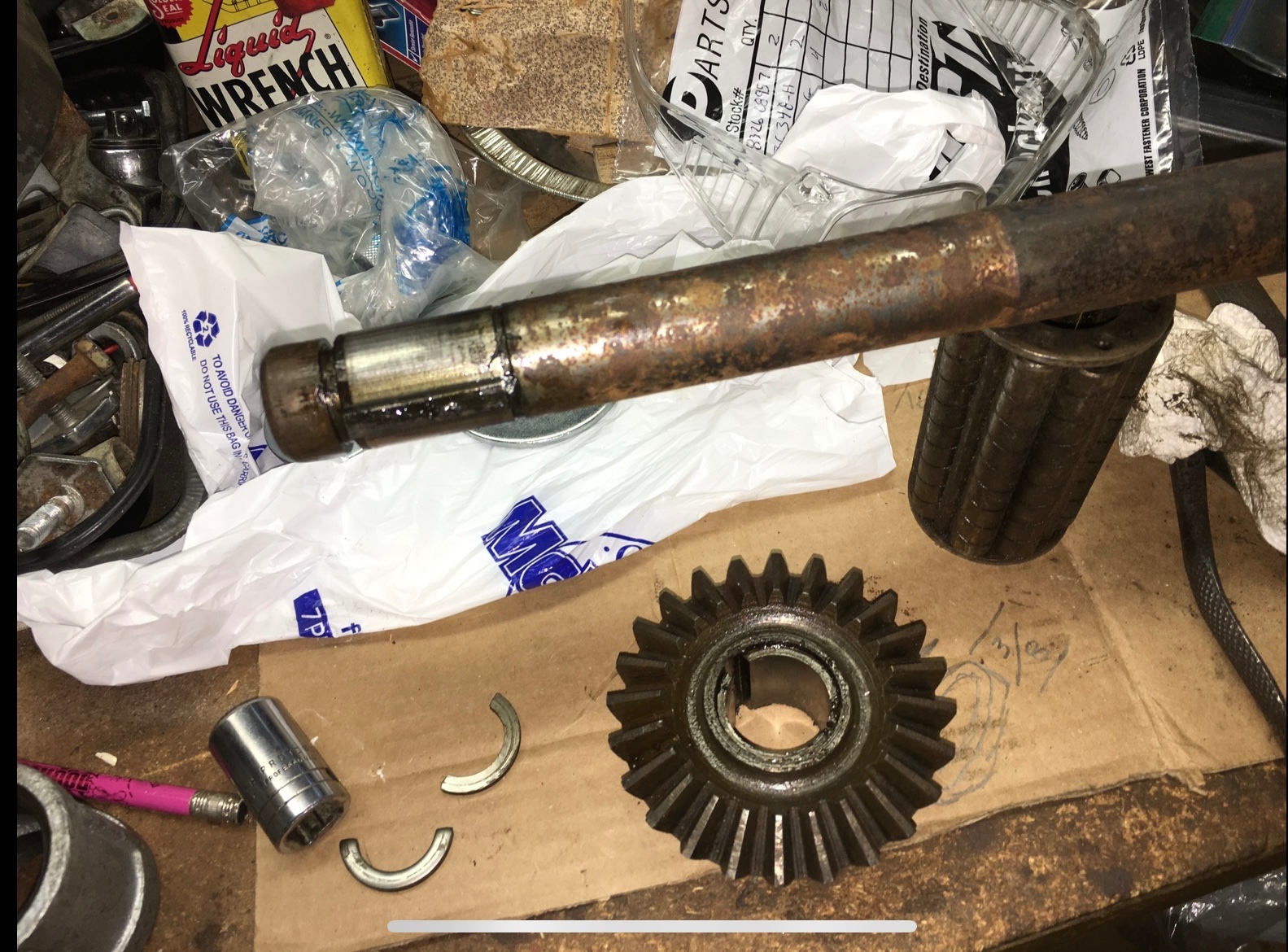

How do I Remove This Gear ?
Topic author - Posts: 2888
- Last Name: House
…or more appropriately: whats the Best way to remove this Model T rear axle gear ?… best way to remove 2 little
half moon keepers ? Then; assuming don’t use oxyacetylene, simply press gear off with my 30 Ton press ? Thank you in advance gh

Thank you John. I like the idea of using the rear hub to protect axle threads. But the threads will extend outboard of the hub so I’ll need 2 hubs, won’t I when pressing the gear down the 3/16” ? No problem; I have plenty. Think I’ll use copious quantities of PB Blaster. Now I’m not too clear on the use of a “long piece of round or square stock most the length of the axle”…I envision only short piece of round pipe to press, outside the axle inner end, the gear downward the 3/16” to remove the 1/2 moon clips then a short solid stock to press the axle downward to remove the gear…..right ?

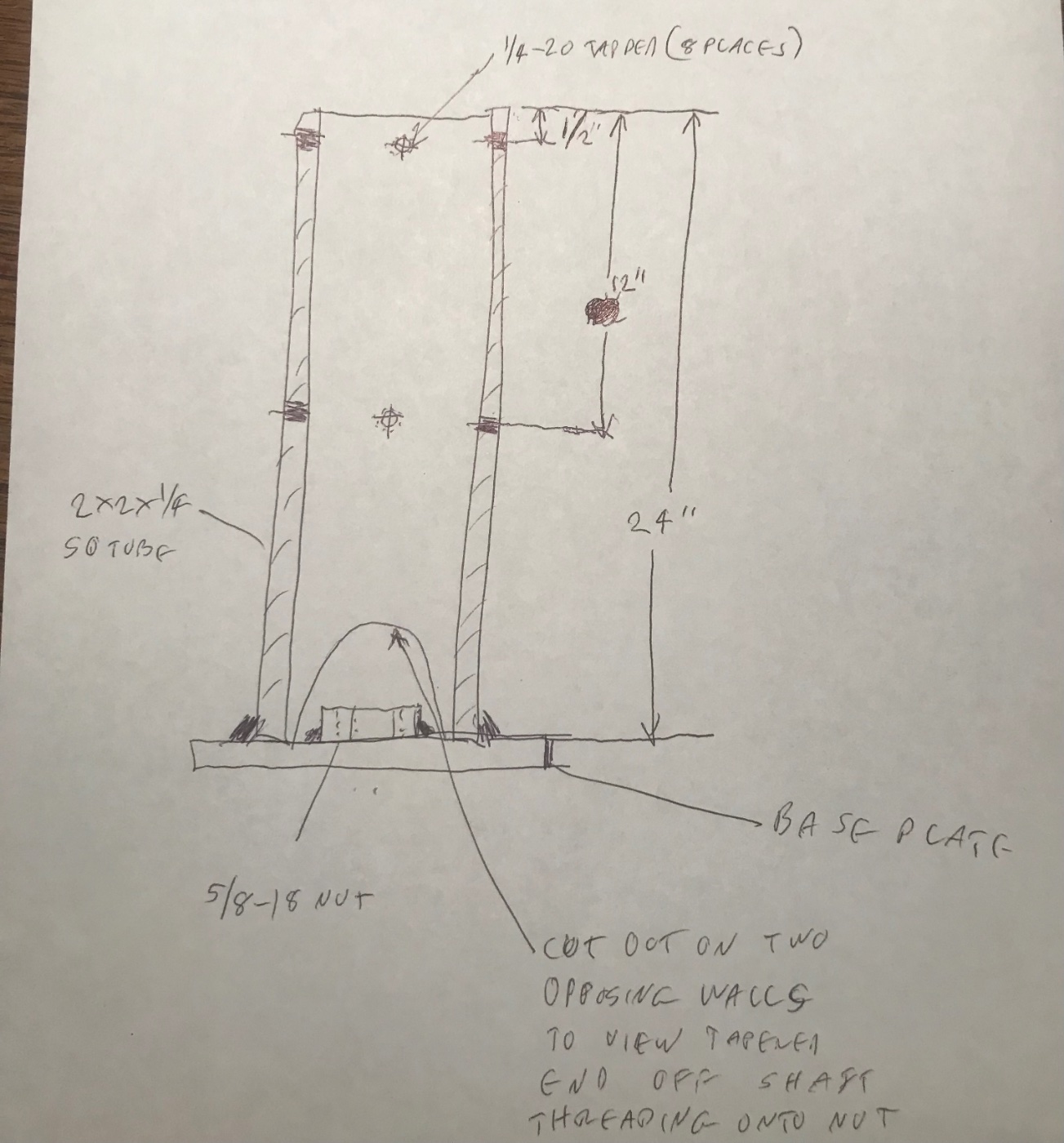

I made a support tube to keep the axle from bending while pressing using a 2x2 square tube fitted with thumb screws so the axle would be supported from bending by the tube before any bending could occur. I ground smooth the ends of the screws so they wouldn’t scar the shaft, and welded a nut at the bottom to protect the threads. Screwed the shaft into the threads until it bottomed out. Maybe overkill, but it worked fine using a 20 ton press.
