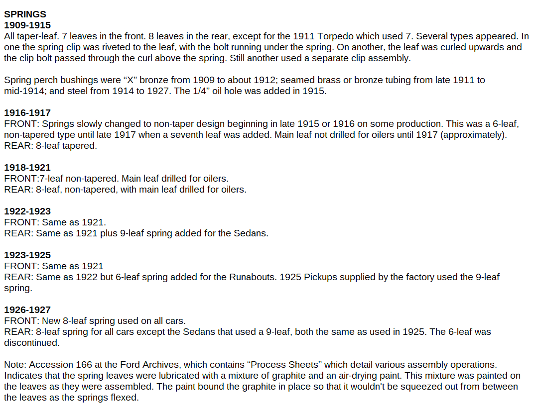

Reviewed several old discussions. Several allude to the 1926-27 being different. Some suggest that the arch was lower to match with with the lower front spindles. Only one picture of two different ones, the difference mentioned was in the number of leaves.  The parts book does indicate differences in the leaves based on a 8 or 9 leaf configuration. 8 leaves for 1918-1927 & 9 leaves for 1922-1927
The encyclopedia describes springs leaves by year & in some case model. But it indicates 6 & 7 leaf versions
It may be that the 8 leaf has a lower arch than the 9 leaf as in this photo.
