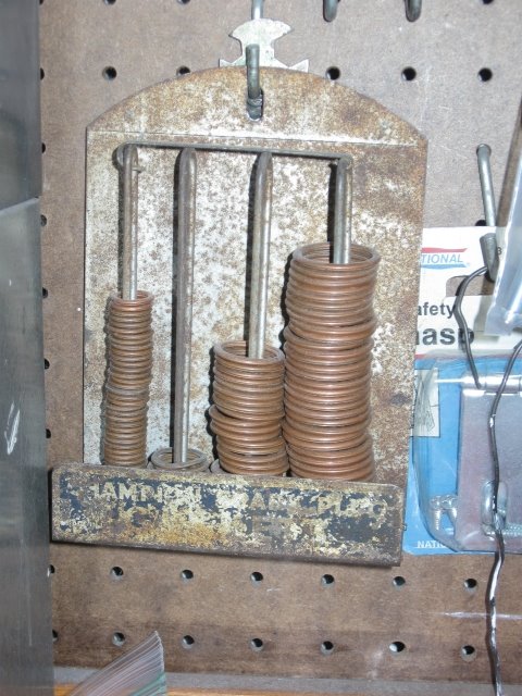

Like Rich, I had gotten some boxes (of different sizes) at a swap meet or auction (I don't remember). With those in the cabinet I should have all my needs covered. The holder that hangs on the pegboard above the bench should last me quite awhile.Rich Eagle wrote: ↑Thu Jan 17, 2019 1:08 pmI bought a box at a closeout sale 30 years ago. I imagine there are some old boxes around somewhere and folks don't know what they are.
Now if I could just find some new gaskets for the take-apart plugs I would be happy.
