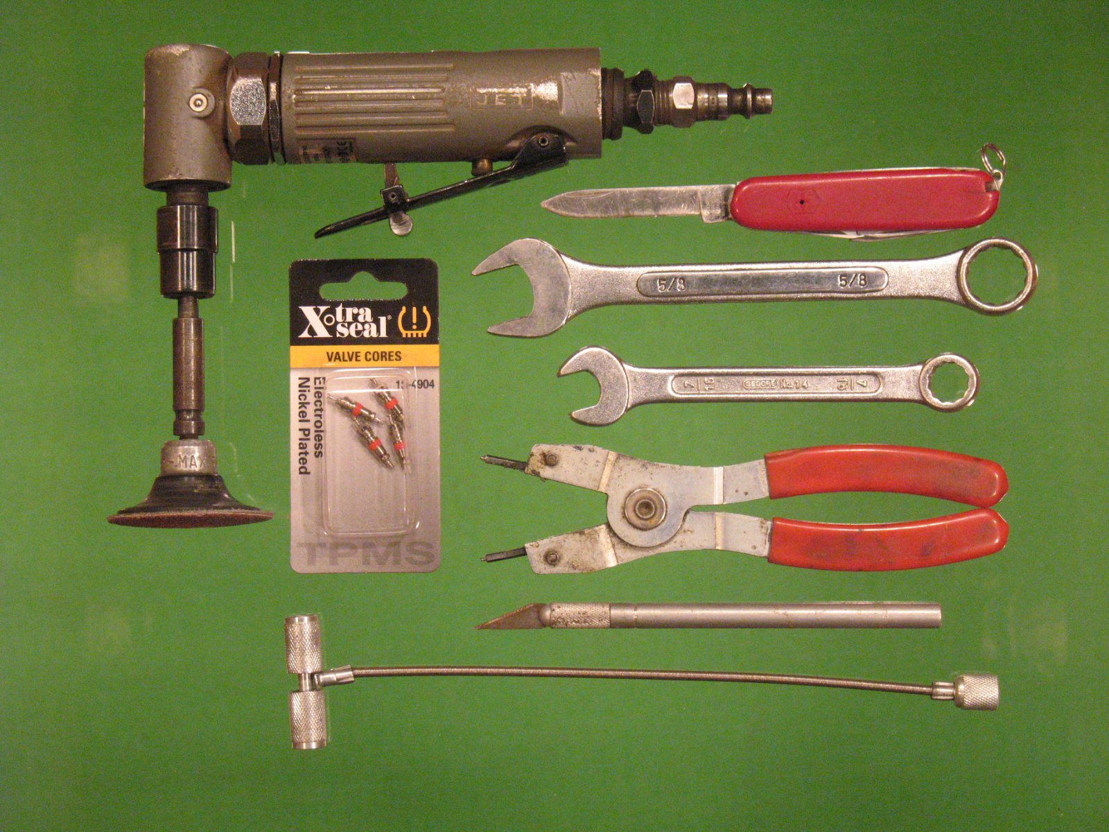

I suppose this is a silly question, but have you removed the valve core from the stem?
The tool at the bottom (core wrench) is for installing or removing valve cores.

Hi Steve, there are no silly questions so thanks. Yes I did remove the valve with the tool. Still no air out. Very strange. I went back out to the garage and put together a lever to allow me to push down on the valve stem into the tire hard and the air came out. So now I can get the tire off and see what happened. My guess is the tire bead closed around the valve stem and squeezed it off. By pushing down I pushed the valve stem past the pinch point. After I get the tire off I will report back on my findings
