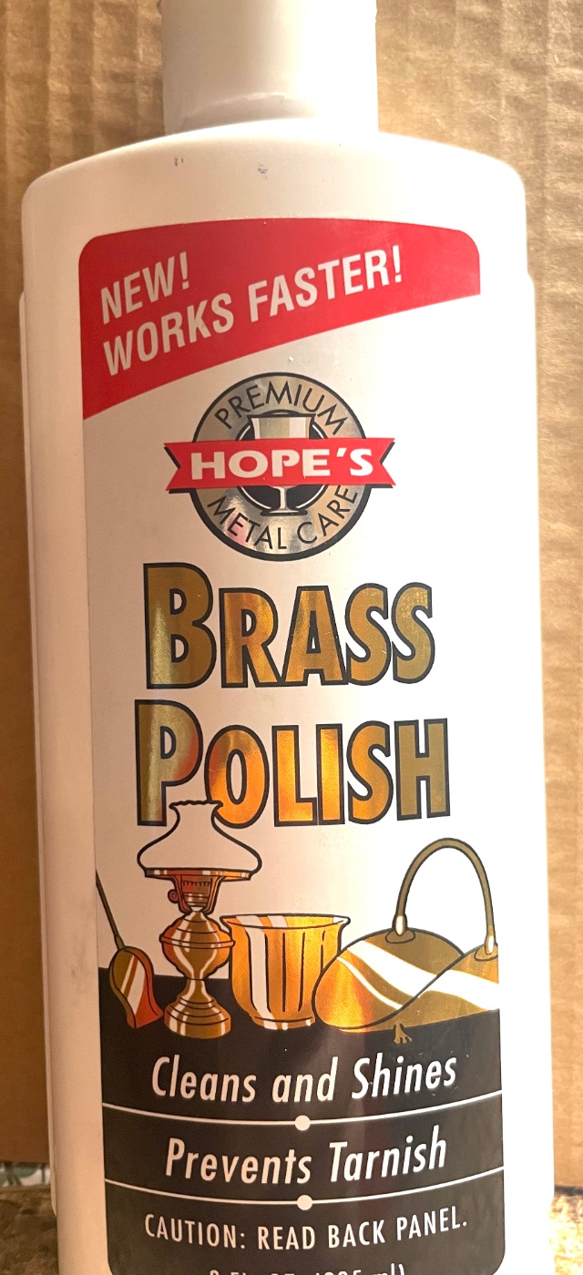

Re: Brass polishing tips/tricks
Interesting video, using power tools. Neat if you are doing mass polishing!
For real dull tarnished parts have used the ketchup trick, it works to remove stubborn brown tarnish!
But for brass windshield for the '12 project, the brown tarnish was removed really fast, by hand, applying about 2 coats. Bit more on some spots, but impressed by this stuff!
