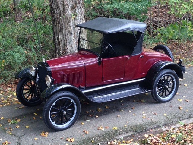

It a little low on power when cruising with other T's. I have never had the engine rebuilt and when I got it the car the head gasket was on backwards so I pulled the head and one of the valves did not look good installed a new head gasket and it ran okay. As mentioned before one of the cylinder seems a little week and you can feel it going up a hill (the same cylinder as the bad valve). That was when I first got it and have driven it that way for several years. I did get the interior and paint done so the car looks great. I have not had the rear end apart and afraid the thrust washers might be bad and need to fix that.
Retirement is coming soon and would like to drive it more and have a little more confidence while out and about.

The car does look great. There are ways of checking the condition of the axle thrust washers, and I'd want to do that before tearing into it. A weak cylinder is a nuisance, but if the axle goes bad, it disables the car entirely.

Yes… beautiful roadster Gerald. You’ll have fun with its future performance. I agree with Pat. Refurbish and revive the ‘26 engine in situ. Primarily because pulling a ‘26-‘27 power pack is more of a pain than earlier engines. Starting with the headlight bar. :roll: I have a ‘26 roadster too. All body styles of these last 2 years tend to be sluggish. Once I achieved stock engine performance, I added an NH straight thru carb on a high volume aluminum intake manifold. Then I added a Scott Conger needle/seat and a Giant Power Head.It ran like a scalded ape but not being content, I also added a KC Warford tranny. I answered your OP by stating ‘yes you can’ but now encourage the ‘26 engine attention. And my roadster even has a painted radiator shell and nickel headlamp rims like yours.
