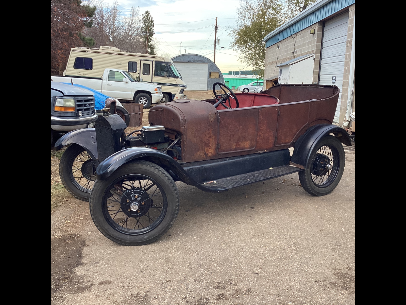

Having more fun with the model T! I’ve been totally awed by the public response and group enthusiasm for this car the whole time it’s been on the road, sooooo….
Decide to sell the roadster body so I can drive a four passenger T. Actually got this touring car body many years ago and planned to use it as a V8 hot rod. Well, that didn’t happen so I figured I’d double my fun by loading more goofballs on board and take it to the streets.
I’ll still need to source correct rear fenders, radiator shell, folding top and windshield and add a wood kit and demountables but for the rest of the summer I can at least fart around the valley and keep the smiles rolling till winter. In case you’re wondering, the 26 windshield posts will fit a 27 better than 27 pieces fit on a 26 body, due to the reveal on its cowl. This is an “early” 26 touring and shows all the specific traits, so my end goal is a non electric base model. I already drive the car with no starter or genny, but will need to get the mag working and figure out the lights over the winter. Looking forward to getting all the facets correct, since this could be considered a fairly rare model, and setting it up as it would have left the factory. Hope everyone is having a great summer and I’m really excited to get the T back out there! -Chris, in Boulder.

Good for you Chris !! With a T, all things are possible ! (well, most, anyway :lol: ) looking good, and a lot of fun !
Here’s a chance for us OCD history types to learn something - I was under the impression all of the “improved” cars were fitted with electric start, and ‘25 was the last year a customer could opt for a “stem winder” ?
