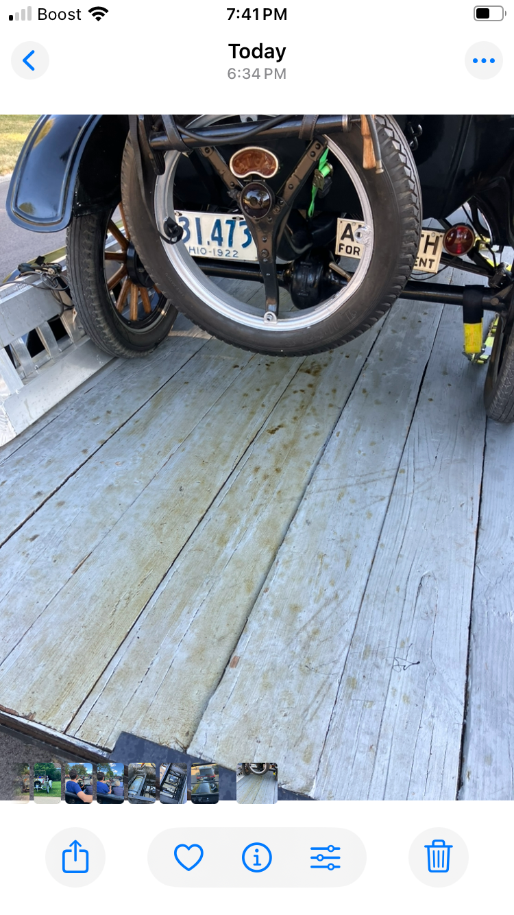

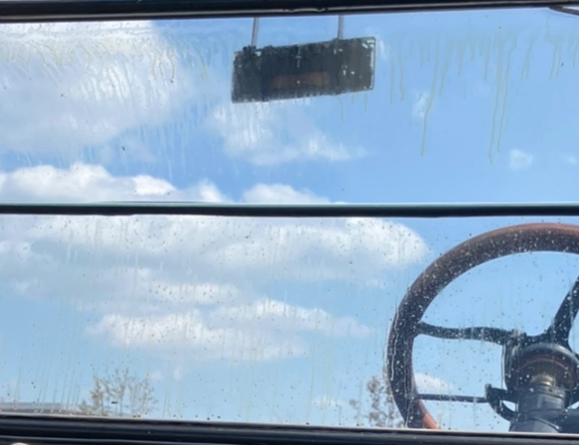

Hi all,
In the years taking the T to OCF, thankfully we never had issues. This year, the car seemed to have splattered oil EVERYWHERE, both there and back while it was on the flatbed trailer. I take the floorboards and seats out, maybe air sucked its way in and out the hogshead? I not talking a little bit…the entire car and trailer is soaked! And probably passersby. Any idea what gives? It’s got both petcock valves closed, oil breather is on….id try to source it….but no way to tell now!

Post by DanTreace » Sun Sep 07, 2025 8:59 pm
The windshield splatter is flowing down, and on the trailer deck the oil looks very fresh, certainly isn't old used oil or fresh pavement oil from the roadways.
Lots on your battery and on the front seat riser points to the motor as source.
Would first check the oil level in the crankcase, and did you overfill with fresh oil prior to the trip?
Would look for the typical oil leak points, the drain plug, around the u-joint, the Bendix Cover, starter mount, rear corners of the hogshead, band inspection cover, crankcase inspection cover. Hopefully you will find that source of oil leakage, which got air sprayed at trailer towing speed, sucking the air rearward over and around the engine.

Until we know from the OP, prefer to go with the hunch on the type of spray indicated , that is source is the Model T.
Look at the windshield pic, I expanded it some. If the oil spray was from the tow vehicle, the spray would be outside.
This oil is on only the inside of the T. Note how the oil is fresh, clear, and at the inside upper frame is lacking, but the flow streams are straight down. That is due to the inside pressures over the windshield that whip the wind down, so the oil was being sprayed up from the motor and into the compartment with some spray on the inside of the windshield.
There is no spray on the front exterior of the T. All the oil spray is inside the compartment.
