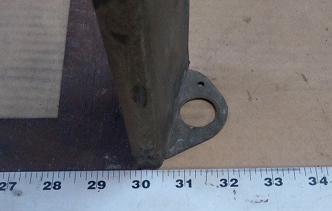

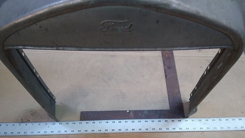

varmint
- Posts: 1024
- First Name: Vernon
- Last Name: Worley
- Location: New Orleans, LA
Re: 26/27 Radiator Shells??
If there is a question about your shells, maybe post a photo like this to show the flare of the high shell:
Vern (Vieux Carre)
- Posts: 7167
Vern, your phpto has the top corners cropped, so we can't see the flare. If the feet at the bottom are shown, they will be angled to show the flare. Those feet are narrower at the back than the front.
varmint
- Posts: 1024
- Last Name: Worley
I suppose even though that photo does not show enough detail, the concept remains that the OP could post a photo of each in question.
Here's my other one from two years ago if this is better:
Vern (Vieux Carre)
- Posts: 7167
Vern, it is better if the foot piece is still fitted. That would show the back edge narrower than the wider front rolled edge, clearly illustrating the flare.
