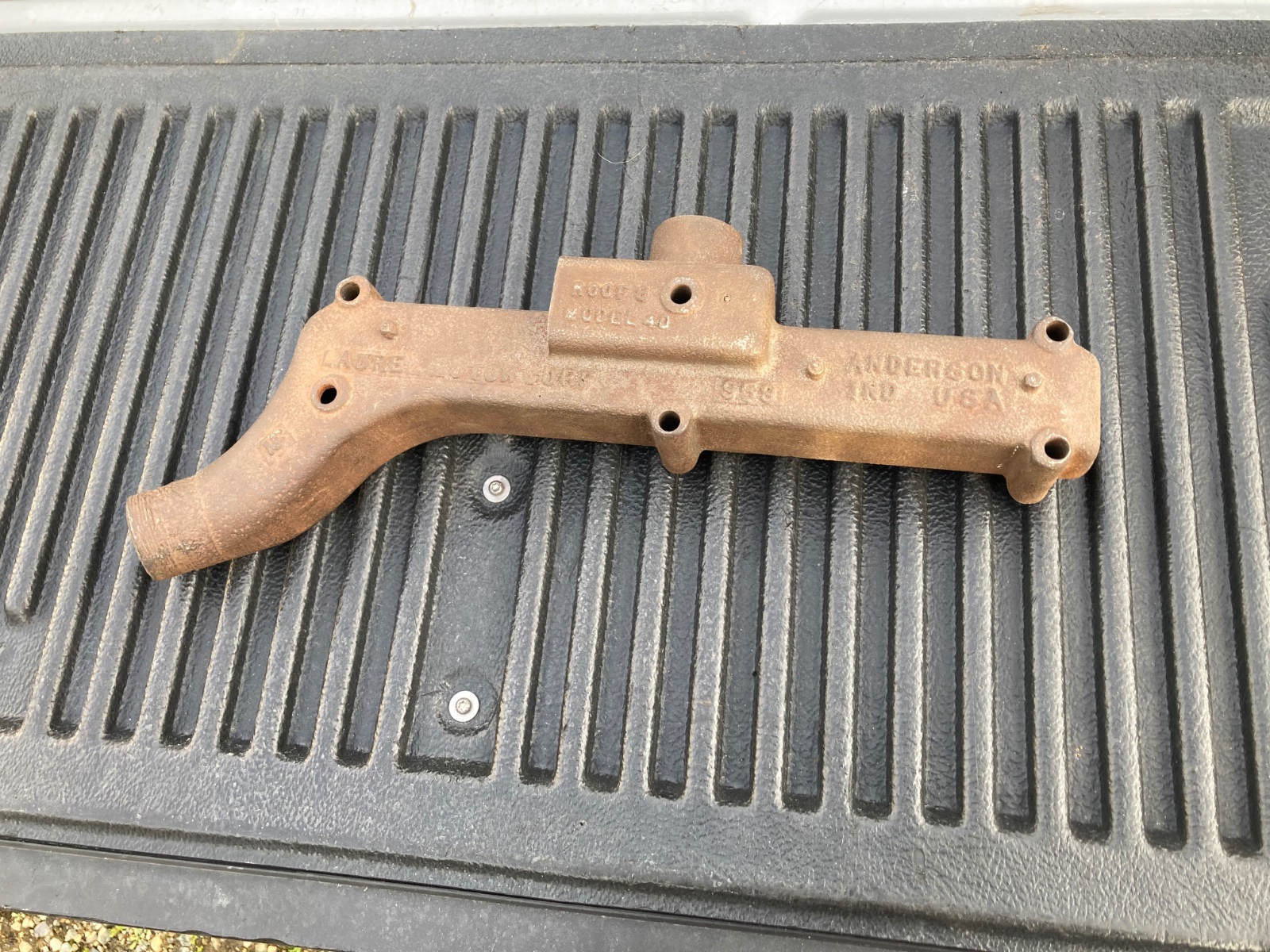

The factory 2 port Roof exhaust manifold looks identical to a Fronty T/S manifold, except the port bolts “lean” at a different angle. Here is a Roof manifold I bought years ago thinking it was a Fronty, then sold it a couple years before finding my own Roof head to match.
The single port Roof heads have vertical bolt pattern

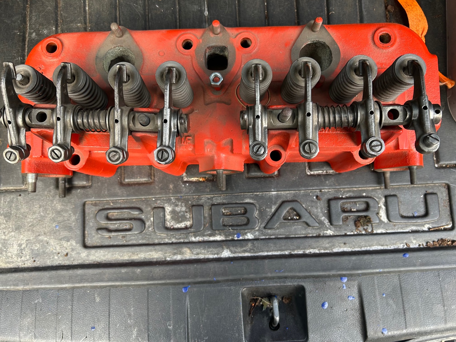

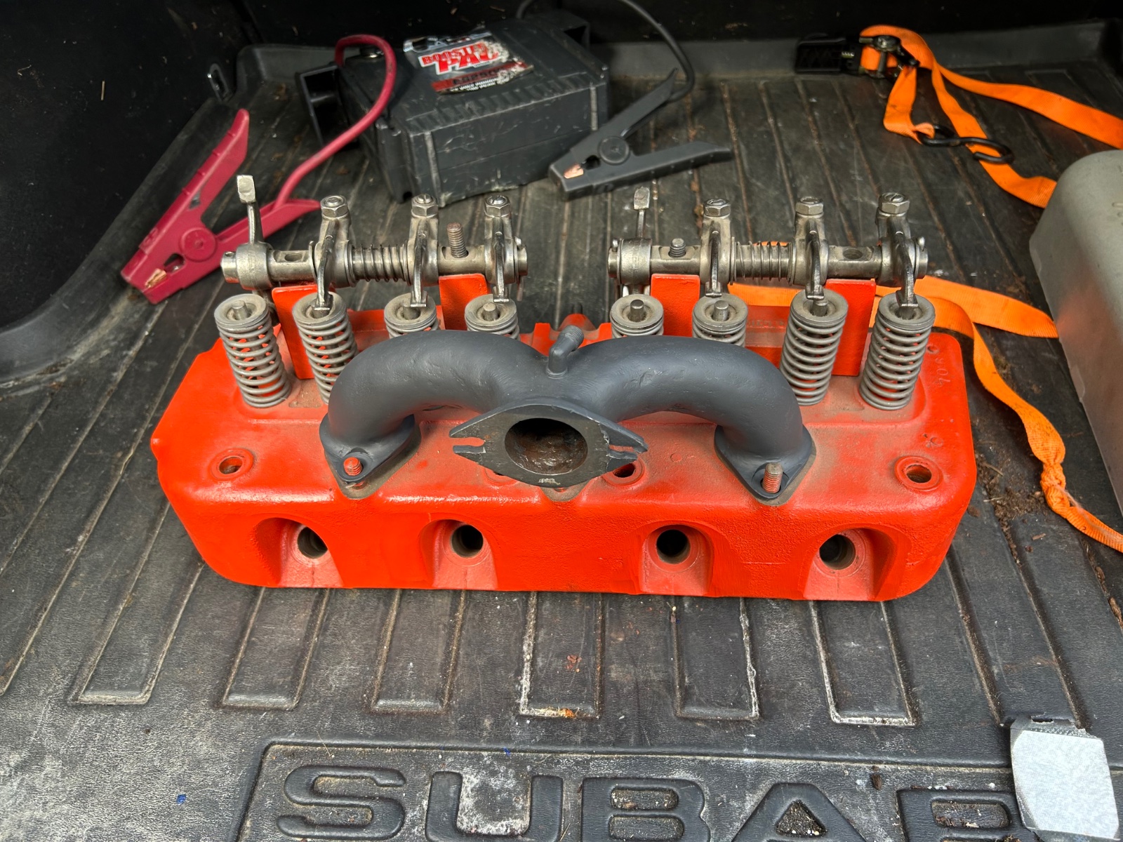

Wish I knew how to post photos here. My head has 2 intake ports on the top of the head. Also it has removable rocker stands with adjustable rockers. The exhaust side of the head has 2 ports. The intake manifold that came with the head appears to be an original casting and at the carburetor flange it is horizontal as to use a stock T carb.
This head appears to be reconditioned and is painted bright orange. If someone here may have known or owned it step up and tell me the history.
thnx
frontyboy.

Uhhhhh… 2 ports on top…? Think it’s time for pics. Here is a shot of a 2 port Roof head. Yours the same…?

can you call me I can't get the photos to go. I'm really confused as to what head I have.

Pics of the cylinder head in question;
The rocker stanchions have “R. R. MFG” cast into them which is typical for Roof. Head bolt layout and exhaust side of head suggest Chevy/Olds 4 based design tho. Have you tried to bolt to a T block yet…?

Roof Chevy heads had the intake ports on top of the head

It is a 4 cylinder Chevrolet ohv head. Moving on might trade for 8 valve T ohv head or sell the Chev head
