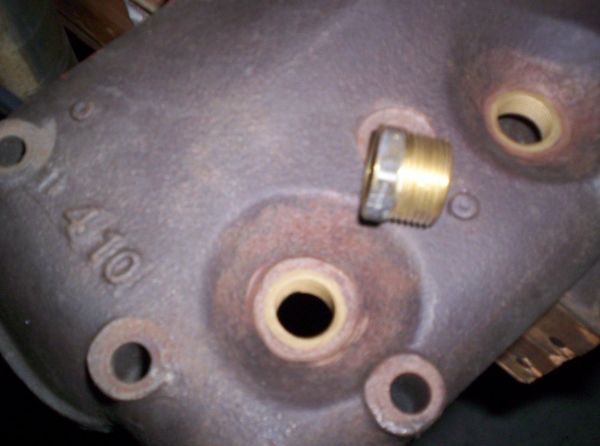

I'll second the get a new head. However, if there is sentimental value or some other reason for keeping it you may have luck with delicious and studs for the water outlet and taping the hole deeper (tapered thread) so that you could then use an explosion whistle and then plug compensating for the deeper threads in case a plug bottoms out. Worst case you mess up a head you were going to replace anyway.
- Posts: 7799
Re: Helicoil or just swap out head?
It might be possible to tap the plug hole out to a larger NPT size and then screw an all-thread pipe bushing into it to get back to the original thread size. The bushing would need to be seated tightly and staked or pinned to keep it in place, then threaded internally to the correct size for the plug.

I had a head with bad threads in it. It was a nice low head so I bored and threaded the holes to take Model A size plugs and took .125 off
of it to use on my speedster.
Works well.

Not a hard repair, done several over the years.
