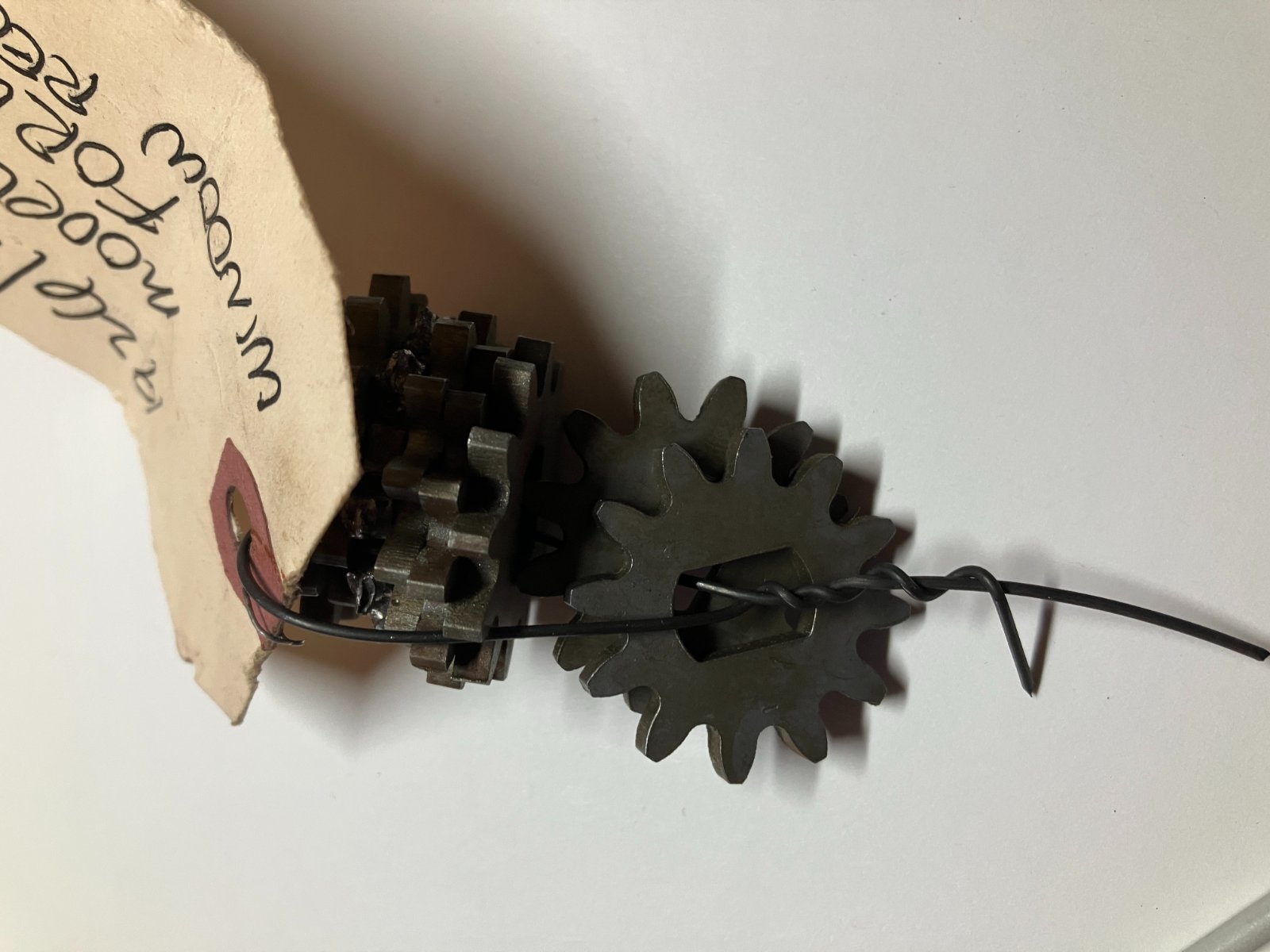

Is this what you need? If so message me you address and I'll send one out to you. These were water jet cut, you may or may not need to do some finesse filing, they are not hardened.

Post by henryford2 » Tue Oct 28, 2025 6:06 pm
sorry reread the post, not what you need.
