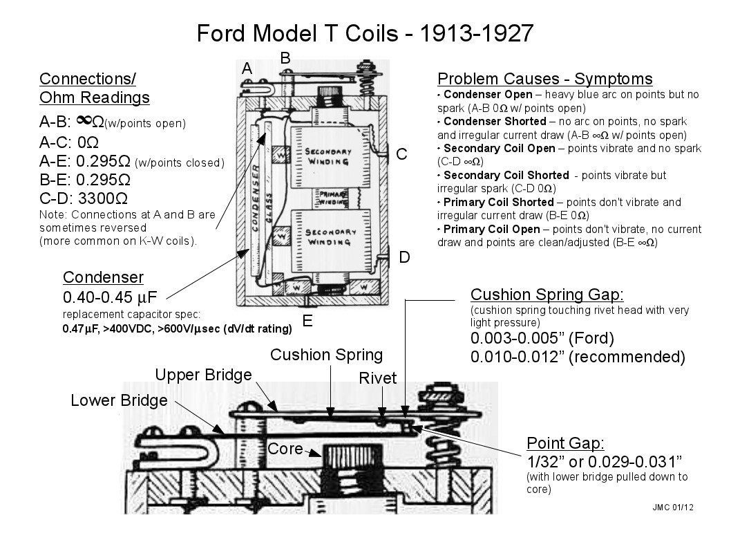

I have rebuilt several coils. Here is what I have used to determine whether a coil is good or not. Most of the time the only problem is the capacitor. You will definitely want to set the cushion spring gaps on your new points. That will make them easier to adjust and run much better. I have come across a few that checked bad but was able to resolder the wires to the contacts on the side, or bottom of the coil. What are you planning to use to check for double spark and adjust the amperage? I have a Strobo Spark from Fun Projects, but they are no longer available.

They are all rebuildable.
The only measurement that matters is the secondary coil resistance and yours are all within the normal range.
I have never seen references to T coil inductance and so don't know what you do with the numbers.
There is a huge amount of info on line about T coils.
