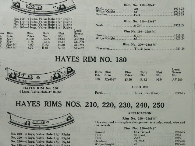

A little more information.
Lugs are attached to the rim.
4 are closed one is open slotted.
Cleaned up one lug is Marked Hayes
Posts: 4083
Re: 23 inch 5 lug demonstrable rims
Post by DanTreace » Sun Nov 16, 2025 9:03 am
Photos show those 5 lug rims to be for straight sided tires, as they are 'split rims'.
Likely for a larger car with wood demountable wheels.

Post by Allan » Sun Nov 16, 2025 8:44 pm
Definitely not for T models, on two counts. Ford always used four lug rims. Secondly, the only split rims Ford did use were 21' rims on the 26-7 cars.
