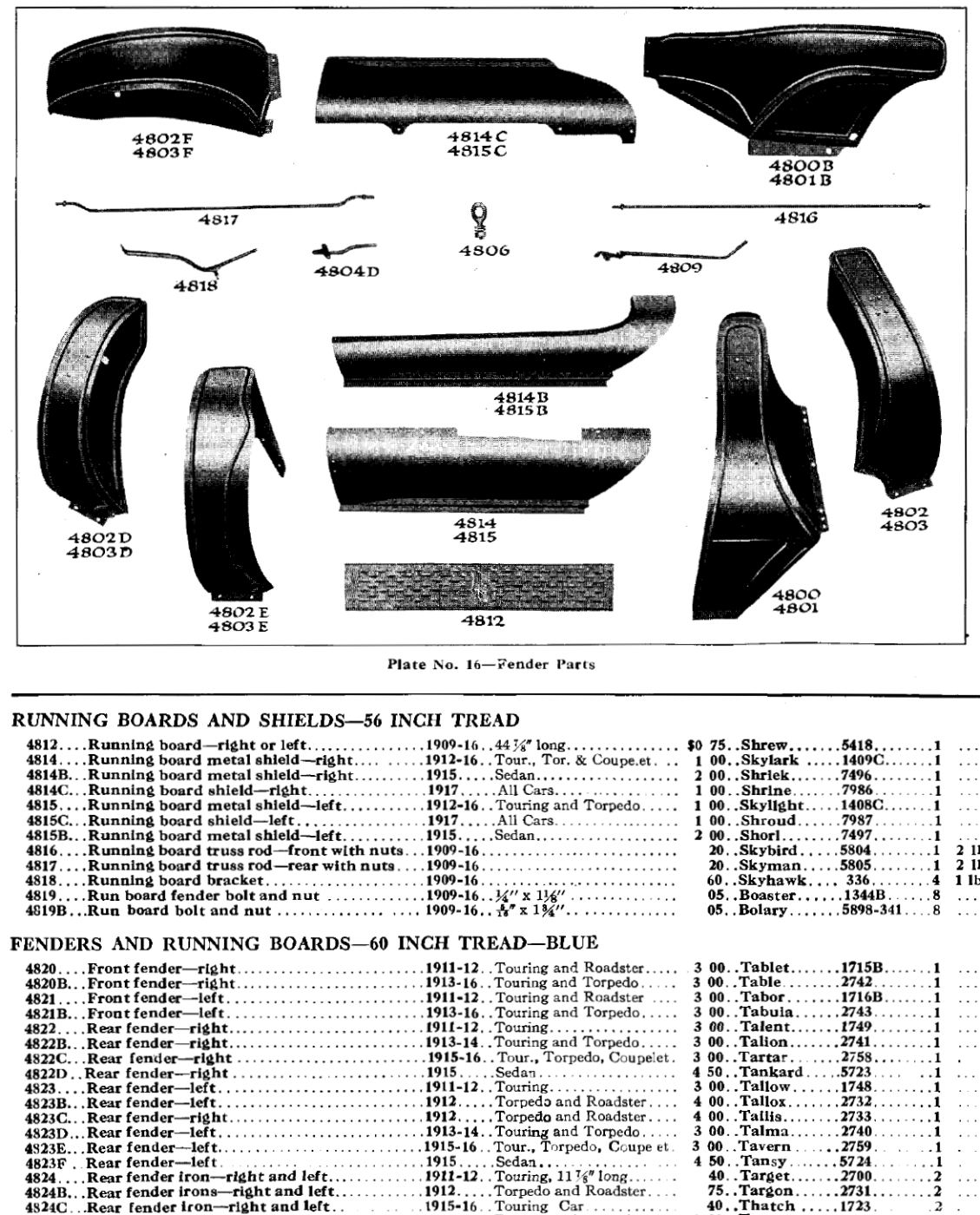

From Ford Parts Manuals - no reference to "splash shields" or 3 or 4 dip pans
