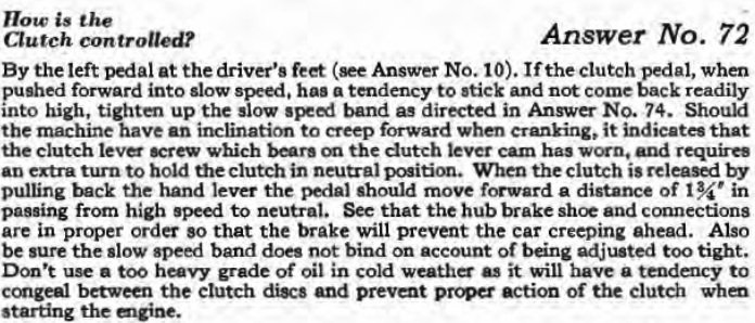

It is a good idea to go down a hill in the same gear you go up. So if you have Ruckstell and the car will pull the hill in Ford high Ruckstell low, go doen the hill in the same hear. If no Ruckstell and you go up in Ford low, go down in Ford low. This will save the brake band and drum in the transmission.

Yes, have frequented the forum for these nine years. What can I say, I'm naive, take people at face value; I have listened to two polarized sides of this argument for a long time. I believe you, that you are telling the truth. I also believe what other are saying and consider that they are not lying to me. So, what do I do? My conclusion is that there must be some hidden knowledge that is not yet shared to explain how both can be true at the same time. The other option is that a large group of people are either mistaken or lying and they have not yet been convinced themselves that they are wrong either. Right now I am operating on the existence of hidden knowledge.
I've used this illustration decades ago (I used black, white, and grey back then.) From a distance, there is a floor, green and red portions. The green you may step on, the red you may not. Enter the brown section of floor, which is red and green mixed. Some say you may not step on the brown because it has red in it. Upon closer inspection of the brown, you find that there is no brown, just tiles of red and green next to each other. I believe there is some hidden knowledge in this brown (grey) area.

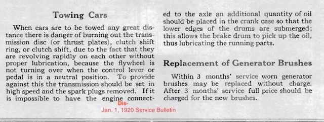

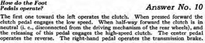

The "hidden knowledge" is that people who have flat towed a T either put it in gear and removed the plugs and drove very slowly so as to not skid the rear tires while attempting to get the heavy transmission/engine up to speed with the drive line, OR they had an auxiliary transmission that had a neutral which will fully disconnect the driveshaft from the transmission.
Any expert who has suggested you tow in "neutral" (which does not truly exist in a "T") either is totally ignorant of how a "T" transmission functions or simply has evil intentions. Either way, those folks are doing you no favors.
With the "T" in "neutral", the main portion of the transmission will not rotate and thus will sling no oil. The brake drum will be spinning with the drive shaft, will be totally unlubricated and now the brake/backingplate bushings will be spinning totally dry, the throw-out bearing will be running totally dry, the clutch plates will be running totally dry, and with enough time, things will pretty much seize up. And it won't be much time.
When people say "well, Royce's dad did thus-and-so, towing a T", understand that Royce's dad KNEW how to flat tow a T because he was a T-trained mechanic from the day they were still on the road - and you can darn sure bet it wasn't in "neutral".
Finally, with an improved "T" restored and in fresh condition, you have lined parking brake shoes and if someone says never use parking brake in an emergency they damn sure don't know what they're talking about. It's very bad practice to use it all the time, but if faced with a certain emergency, there is no harm or shame in grabbing the handle. BTW, you will learn very soon that you drive a "T with your eyes FAR down the road and plan your traffic lights. Cars and stupid people will still surprise you but a functioning traffic light really shouldn't (there's never been one that failed to go "RED" on a very regular and predictable basis yet)

I would not flat tow a T unless in an extreme emergency. The only correct way to flat tow a Model T is to remove the spark plugs and put the lever all the way forward. If you tow with a tow bar, Do NOT back up!
The model T transmission has no neutral, unlike most transmissions. "Neutral" is obtained in the T by holding the clutch out of engagement, either with the foot pedal or the hand lever. Both methods do the same thing, which is to hold the clutch spring back from pressing on the clutch discs. Since the clutch driven side turns whenever the car is moving and the clutch linkage is not, a bearing has to be provided. On a Model T, this is a bronze fork that engages a groove. It is not intended for continuous duty. It is normally not under any pressure when the car is running. It is under considerable pressure whenever the clutch is disengaged, which is normally not for any extended period of time, and normally the engine would be running during that time and circulating oil to moving parts. When towing the car with the engine stopped, no oil is being circulated, which exposes the transmission parts AND the throwout fork to lack of lubrication if the car is towed with the clutch held out of engagement. The solution is to tow the car, if you must flat tow it, with the spark plugs out and the lever forward, and never try to back up when flat towing a T.....

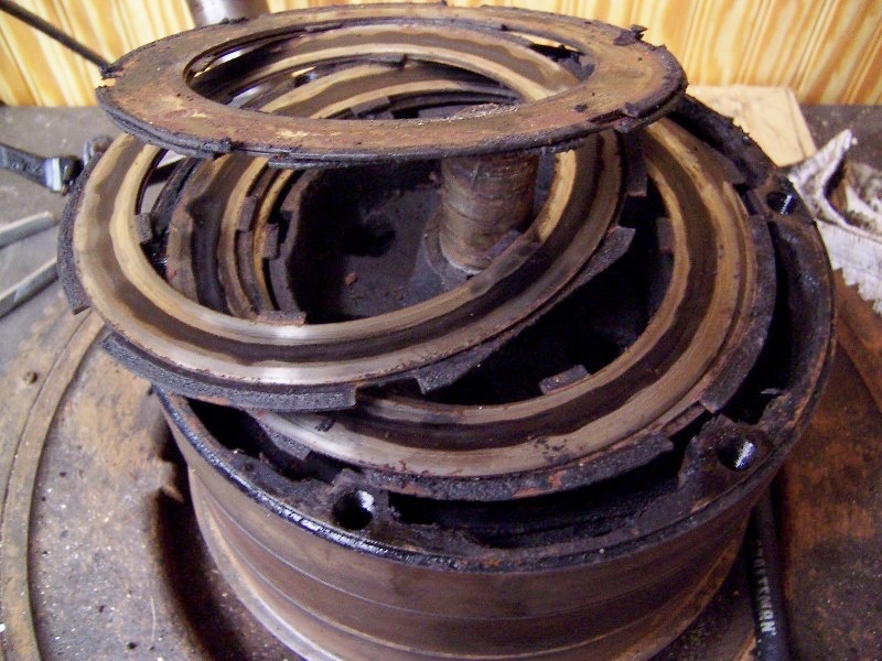

Flat towing in neutral. :( :(
Scott is right on about the bushings running dry, & quickley. The most @ risk bushings are that of the triple gears. The gears will be spinning very fast, faster than normal @ tow speeds & likely seize up first. Melt the pins, possibly shear. Steel clutch disks still have friction & will be dry quickly. They get hot, blue & try to fuse together. That $225 tow looks like a great deal now!
The flywheel MUST be spinning to keep these bushings lubricated. Towed with the plugs out works. (if there are no internal motor issues)
It is possible to seize triple gears in neutral, reverse or low gear with the engine running, if tight, as in a fresh rebuild. Those 3 conditions involve the triple gears. High does not. For this reason I encourage fresh motor startups to run a while in high gear with a wheel off the ground for some break in & well lubricate inner bushings.
Those that suggest towing in neutral dont understand how a T planetary transmission works. There is no real "clutch" as in later automobiles.

I thought the triple gears stayed still with all the bands released, such as when running in high, or towing in high. (?)
Posts: 5273
First Name: john
Last Name: karvaly
Location: orange, ca
Re: Crazy? tow question
Post by speedytinc » Sat Nov 29, 2025 6:22 pm
TXGOAT2 wrote:
Sat Nov 29, 2025 6:14 pm
True.
In high gear the triple gears are moving fixed on the flywheel, with the flywheel, not individually spinning as in engaged.

Now I'm a little upset with Henry! In the Ford Manual, "The Car and It's Operation", he 1) states clearly that there is a neutral, 2) he sold 15 million cars to the public, and 3) he did not warn any of those 15 million about using neutral, that I can find in the manual.
Vern (Vieux Carre)
Posts: 8665
Post by TXGOAT2 » Thu Dec 04, 2025 4:49 am
There is no neutral in the Ford T transmission. To allow the engine to run with the car stopped, or to move it without the engine turning, it is necessary to disengage the clutch and keep it disengaged. If the car is towed or coasted for more than a short distance with the wheels on the ground and the engine NOT revolving, the transmission and clutch will be damaged or destroyed due to lack of lubrication. "Coasting" in a Model T, more especially with the engine stopped, is not a good idea for several reasons, as explained above. In most all other cars, the transmission has a actual neutral, in which the gears can be arranged so that no power is transmitted. In most all other cars, the clutch is placed between the engine and the transmission. In the Model T, the clutch is located behind the transmission. In the Model T, unlike many other vehicles, both the engine and transmission and wet clutch depend on the engine turning for lubrication.
Posts: 8665
Post by TXGOAT2 » Thu Dec 04, 2025 4:50 am
"THE CLUTCH IS IN NEUTRAL"
The clutch, NOT the transmission!!!! This is significant!

For the ultimate in Ford free-wheeling in 'neutral' just install this amazing device.
Claimed aid in driving satisfaction and saving on gas too!
Free wheeling clutch04738.jpeg (46.59 KiB) Viewed 7573 times
Free wheeling clutch.jpeg (31.8 KiB) Viewed 7573 times
Do away with the old sticky Ford discs in that clutch drum!

That is the Ford Service Bulletin, 1920, recommendation too, with some added oil to have the brake drum edge submerged.
Posts: 8665
Post by TXGOAT2 » Sat Dec 06, 2025 6:59 pm
They don't say how much additional oil over the normal full level would be required to submerge the lower part of the brake drum. Leakage might be a real nuisance....
Looking at a ghost view of the engine and transmission, it looks like the oil level would need to be at or just above the lower 2 bolts at the fourth main with the car on a level surface.
There should be no need to put oil in the engine cylinders if there is plenty of oil in the pan and the engine is turning.
