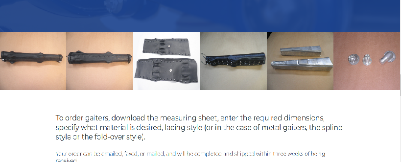

The Alemite gaiters are the best thing going, if you can find any. Ford and other makers used them, or something very similar, in the late 1930s and 1940s. There is a company making gaiters for antique cars to order. Searching "Spring Gaiters" might locate them. A set of gaiters, front and rear combined with double acting hydraulic shocks would make a very good riding and handling T.

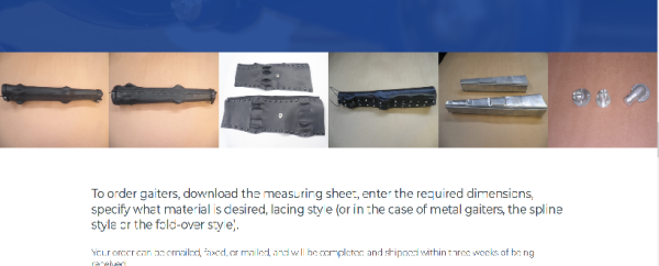

These Companies make spring gators
Accents unlimited https://accentsunlimitedgaiters.com/#about --

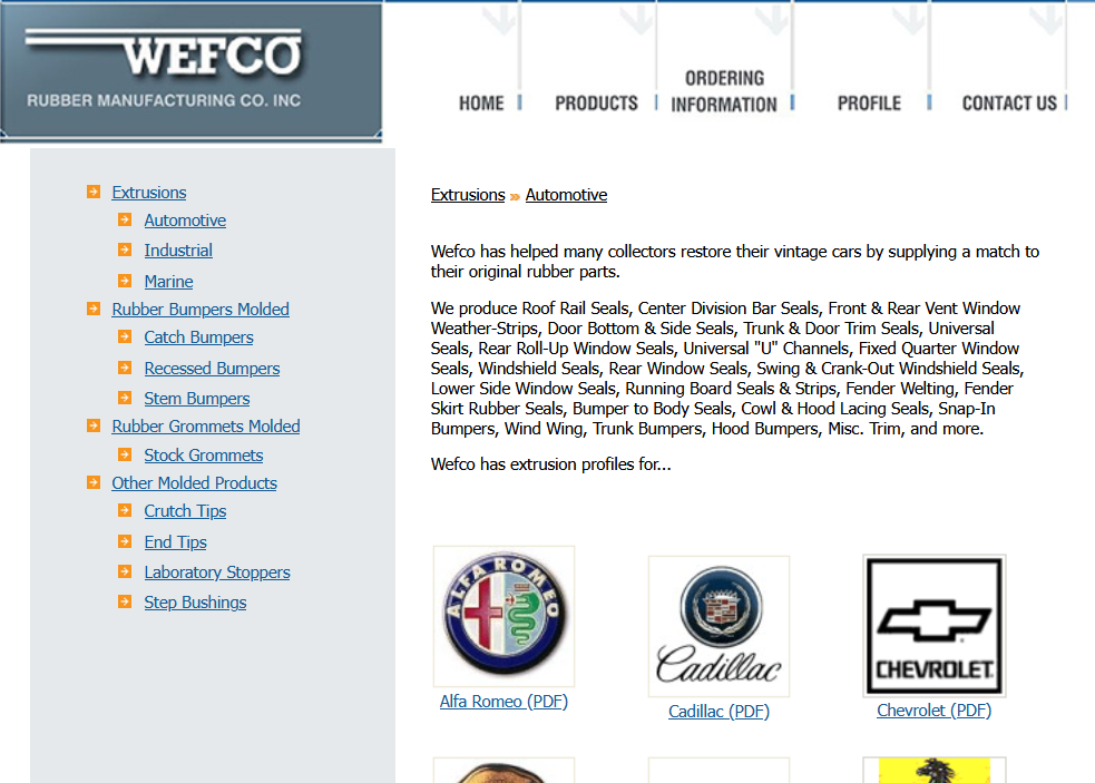

WEFCO not obvious https://www.wefcorubber.com/extrusions_auto.asp The following are general custom rubber molders like Rubbertech, Butser Rubber, and AE Rubber. Likely would need plenty quantity
