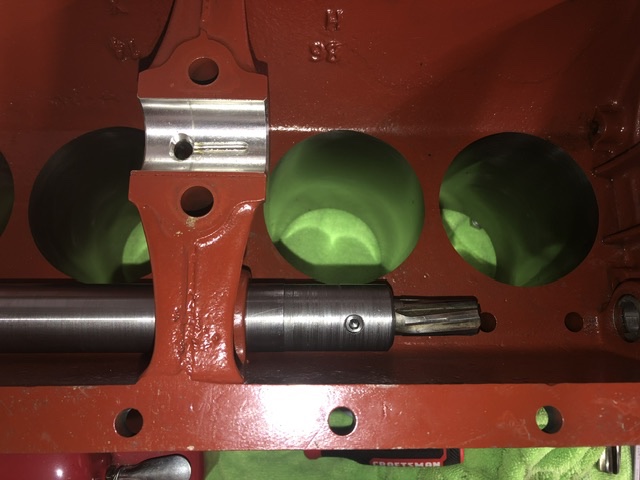

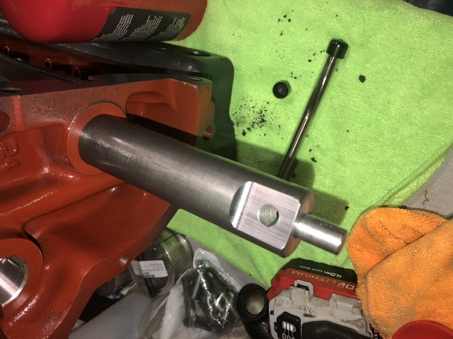

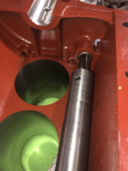

This is mine. I have multiple standard and undersized reamers. I think these are jig bore reamers. Had it made so it can be powered by a drill motor, wrench or piece of bar stock. Cost about $250 to have it made locally. May be a little too far from you though.
Brad

Thanks for the photo's and information! To my knowledge there are not any model t ford clubs in Utah so I joined the MTFCA so that I have some information flow. Possibly I can find a machine shop in the area that would consider making one, most shops I have found do not have the time or interest in model t fords. It is all about available time and money. Thanks everyone, John

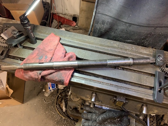

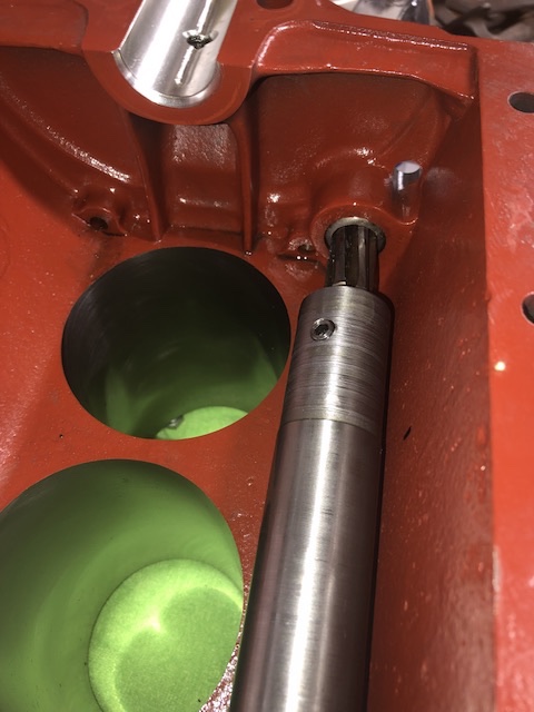

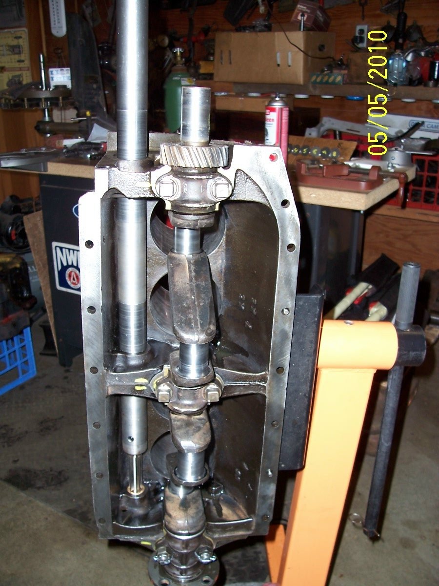

I've used mine on every engine out of my shop for the last 30 + years !

Every engine

No - just seems to be a good practice being how flimsy a T camshaft is.
Not that I perceived.
Anytime a bushing is installed as a "press fit", no matter what the material the bushing is made of, reaming is prudent.

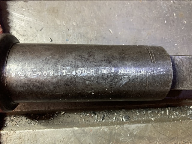

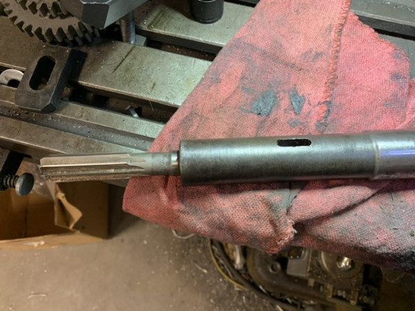

Here is the numbers on mine. Looks like it maybe a Z tool?

In the many years that I have frequented this Forum, I have NEVER seen one of these for sale. For this reason, I made my own.
You will likely have to either hire a machine shop to do it or make it yourself like Steve Tomaso and Brad Kirtner had done in their posts above. You can see that they are simple jobs to make and chucking reamers of all sizes are available commercially. You will want either a straight cut or left hand spiral reamer fit to the tool
