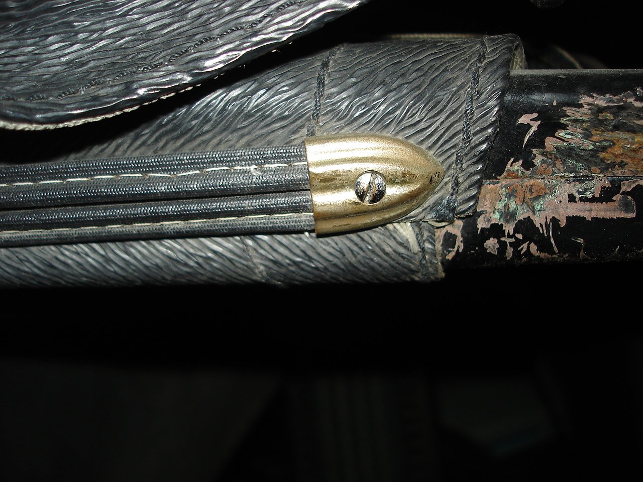

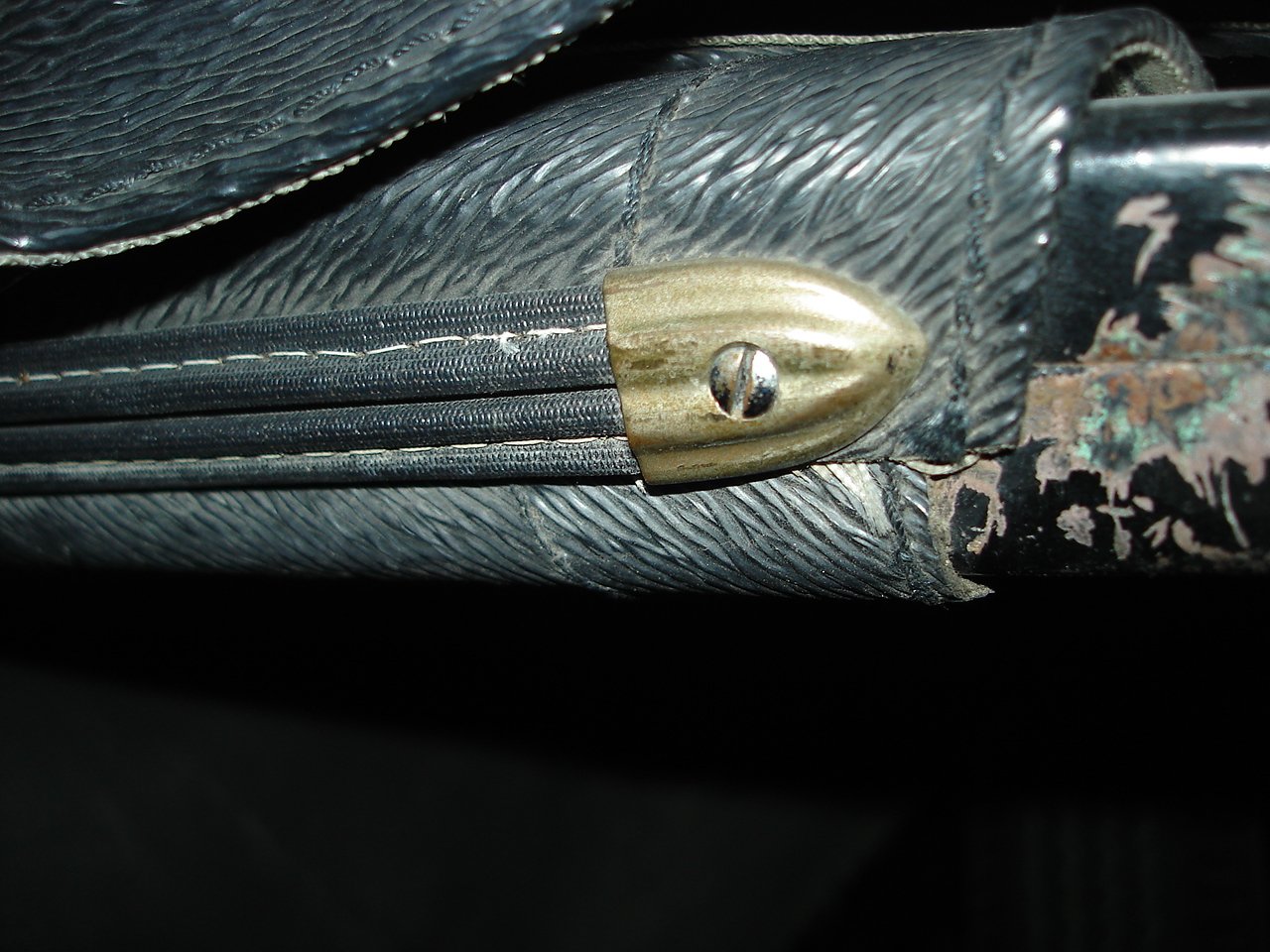

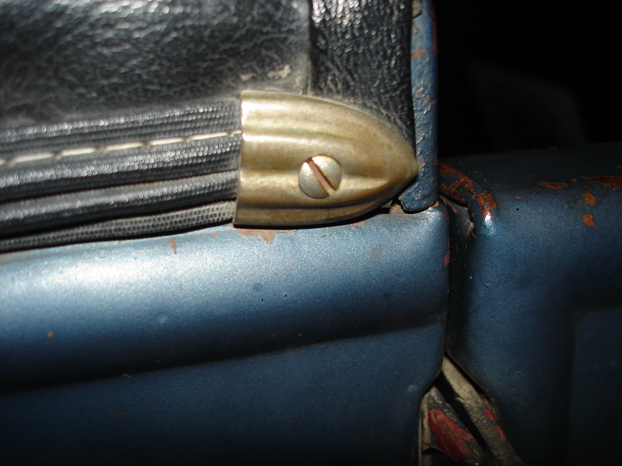

While you are at it replace that bow! Keep your eyes open for correct hidem tips too! They are hard to find.

I’m definitely going to replace that bow. The only thing holding it up was the wrap. There’s a 3rd generation family-owned millworks 15 minutes from me and I plan go there tomorrow and pick up a piece of clear white ash.Original Smith wrote: ↑Tue Mar 17, 2026 5:39 pmWhile you are at it replace that bow! Keep your eyes open for correct hidem tips too! They are hard to find.
I wouldn’t know a “correct” hidem tip if it bit me, but I’ve saved the ones that were on the car, and the Classtique kit came with new ones as well.

How I found out about the hidem welt tips is from Steve Coniff. A photo of one is in the article in Bruce's black book. I went to Hershey for 37 straight years without missing one, and that is where I managed to find some. Kim Dobbins now owns that pickup. The reason for this is when tops were replaced, the original tips were discarded, and replaced with shiny replacements which look similar, but have no tails.
- Posts: 4501
Re: New Classtique Top for my ‘24 Touring
And more original tips...
Looking a bit different than Larry's, but since my dad got the car with it's original top, and he was the only owner since he got it in 1940, I'm betting they were with the original top. He would have re-used them in the two tops he made for the car over the years. Sadly, I can no longer ask him about it.

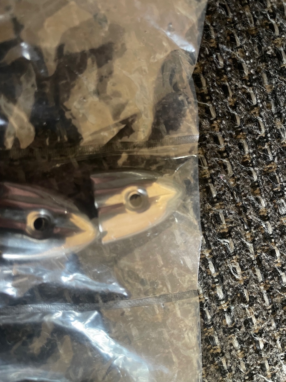

The ones that came in the kit are close to the same shape as Jerry’s, except the outer creases are straight and don’t follow the outside, and are either stainless steel or nickel plated. My old ones are completely smooth, no creases to fit to the welt.
