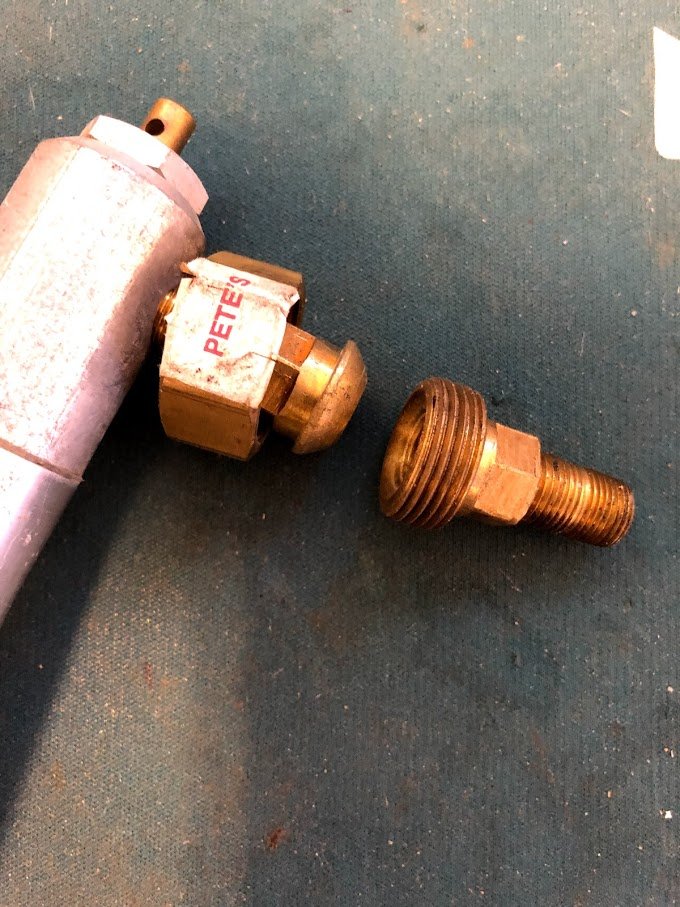

I need help replacing the connector on my wolf whistle which just broke and isnt fixable. Does any know anyone know where I can source this type of connector?
it appears to be 1/8"-27 NPT x ?? -16. Not sure of the dimensions of the large end. I don't have anything to compare it to. It's smaller than 1/2" pipe thread and 16 TPI.

Here's the parts I bought from the local hardware store for mine back in the 70s. That's when hardware stores sold hardware. I just pull the plug in my manifold and install. It's not a pipe thread and I only use it now and then for special occassions. Normally it's off the car.
Hopefully the picture helps you. I can get you thread and size if you need.

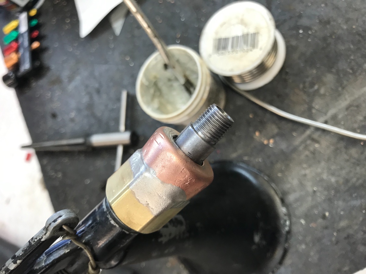

Thanks for the info. I’m headed to the hardware store. I might have some ideas for brass fittings that could work. Perhaps a little brazing is in my future, but that’s why I refilled my oxy tank, right?

Sometimes you just have to sleep on the problem before you can come up with a fix. I had all these parts in my parts bin and with a little bit of brazing and some ingenuity the new part works better than the old one does.
