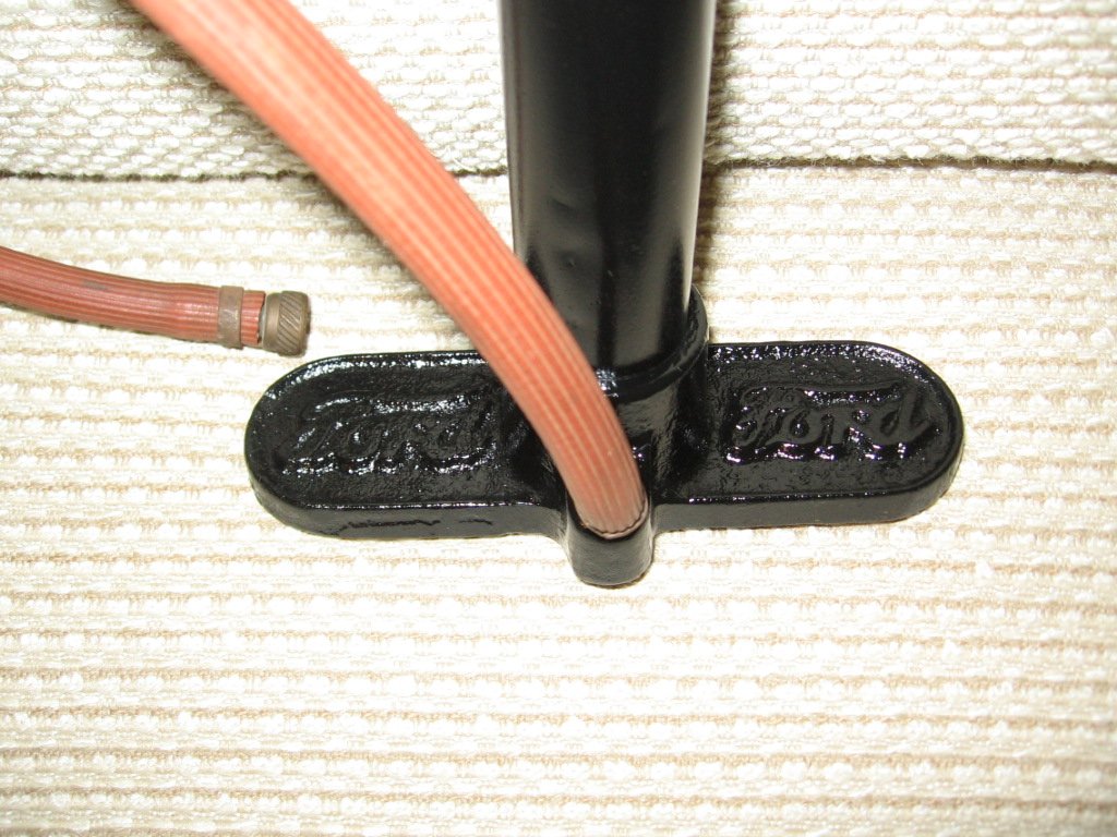

The single barrel Ford script tire pumps don't appear to be as common as the double barrel non Ford script pump. I've never seen a double barrel Ford script pump. Has anyone else? I would like to find out more on the double barrel pumps. There is a check valve between the two stages. Is it spring loaded? Never been able to get one to work.

I have a pump identical to the one shown. It has a nickel plated barrel. I always thought that they were for the Model A's.
The Model T pump with the brass barrel and the two large FORD script on the base where your feet hold down the pump are the more common pumps that I see.

I think Jim is right, the waffle pattern base ones are Model A. Here are some pictures of a single tube pump that I bought for my 1924 Model T. A lot of folks polish up the brass body, but I'm betting that they were painted black originally. :)
