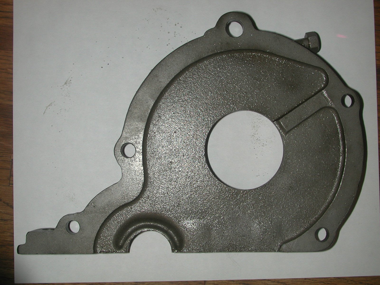

Re: Question on Oil Fill Timers...
Here is an image of an oil-fill timer (that has a later oil cap) and is mounted on an (earlier) non-oil-fill timer block. I dunno whose. I wish I could photo credit.
The blocks that used the oil-fill timer have this funny hump on the back side of the timing gear. It is essentially a widened oil passage.
This is an old photo of my engine:
Here is an image of the inside of the oil-fill timer timing gear cover:
The diagonal bit matched up with the hump on the back side of the timing gears and was intended to direct the oil past the timing gears and down. The problem was the oil went all directions!
Most people have never heard of the oil-fill timer and for good reason!
- Posts: 2547
- Last Name: Strange
- Location: Hillsboro, MO
- Board Member Since: 2013
Thanks for those pics, I wondered how the oil made it to the sump when you poured it into the timer.
