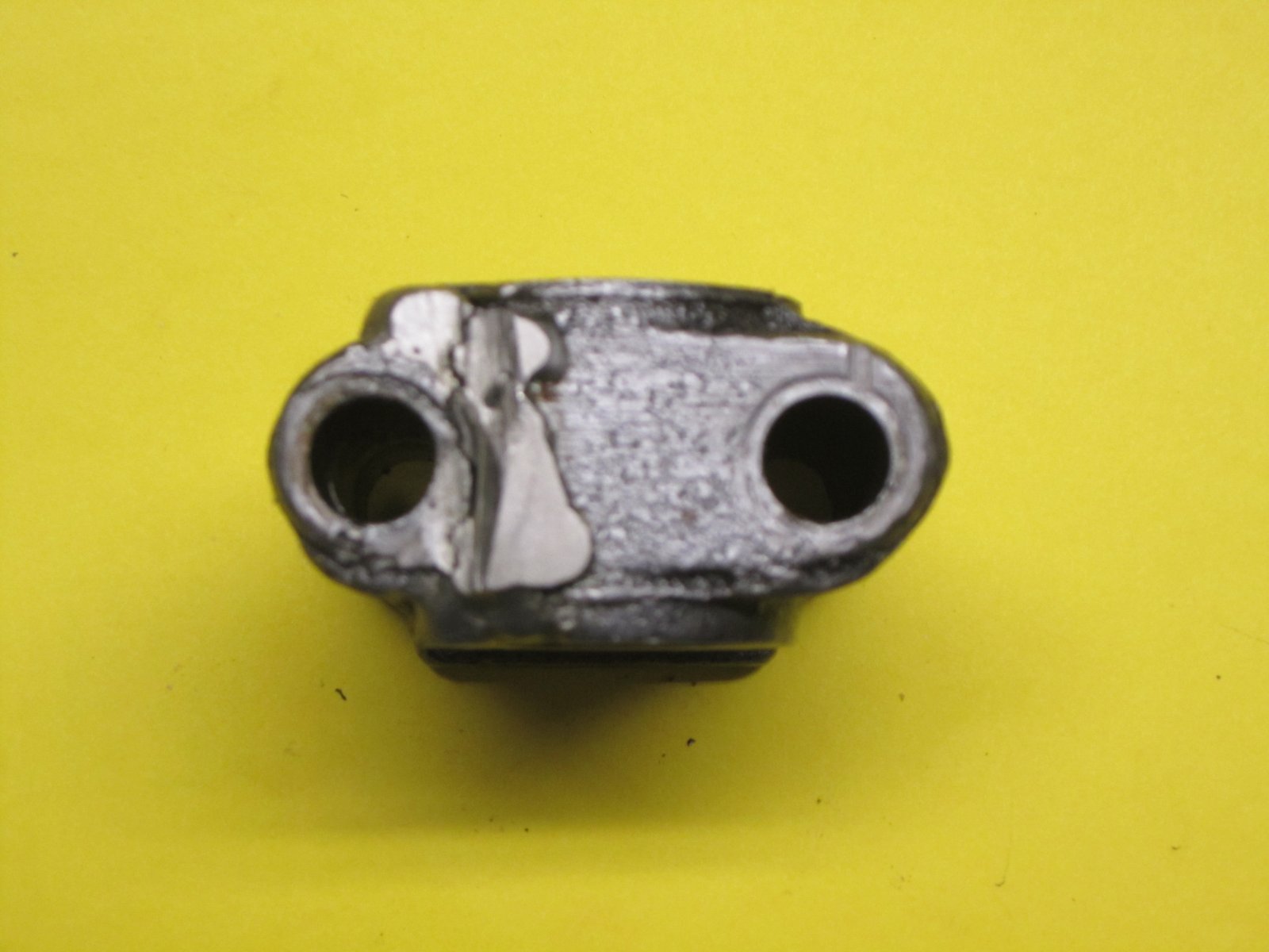

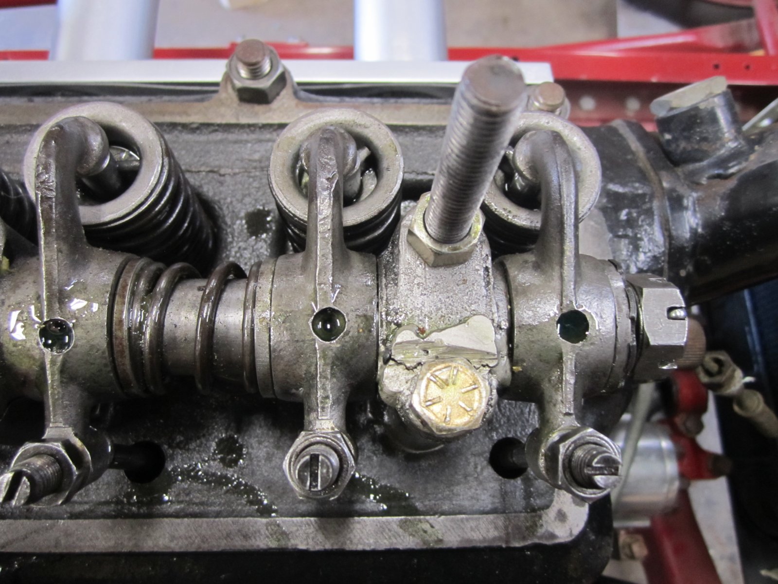

The inevitable happened, my repaired rocker arm stand cracked along the weld. The repair was original to the car when I bought it. I'm soliciting opinions and help. My options as I see them:
Leave it broke, where' s anything going to go? The bolt is hold down the cracked end I can't see the valve/pushrod action moving it? Not planning on "red lining" the engine.
Find a club member who may have an extra surplus to their needs (could use two)
Find a club member who can repair the repair. Have no idea what "rod" was used to make the original repair. Or someone else whose capable
Find a club member who can make new. Or someone else who is capable. I've attached a CAD drawing I did "years" ago in anticipation.

I sure would not leave it as-is
It looks like a simple enough part to fabricate and would not be surprised if someone doesn't have spares or a pattern. Even made from solid would not be too big a job, frankly.

I had new stands machined for my BB from T-6 block aluminum then line bored 25 years ago - didn't cost that much.

Joseph, If you need It welded I have a Process for welding cast Iron. It Is called spray welding. I just repaired a broken part for a Duesenberg car that was irreplaceable. The weld Is as strong as the parent metal and does not leave any stress as conventional welding does. My opinion would be to make new ones and I could do that at a small cost. I have a 16K sq ft shop with any kind of equipment you could emagion, Both conventional and CNC. Bill

Thanks for all the help. It is indeed a simple part and more than likely I'll have one made. I've had a number of people offering. I am still holding out hope that someone may have an original laying around surplus to their needs. I've attached a copy of pictures that might help you identify that "mysterious" rocker arm stand sitting on your shelf and a way to get the post back to the top. Thanks again

THEN, to NOT simply clamp the shaft. I have to believe that for longevity's sake, there needs to be a stack of peelable brass shims in that slot so that the stud can be torqued against a non-resisting surface! I have never seen this part and am equally unacquainted with speed equipment, but can say without hesitation that if this was originally designed to not to be used with a shim pack, then this is a pi$$-poor design for anything that is going to be tightened beyond finger tight.
Once repaired, I would treat all other rocker shaft stands thusly as well.

Scott interesting observation, couldn't the same be said for the manner in which the Model T Ford connecting rod and piston pin are held tight? I think the failure is a combination of poor design (not enough meat and wrong material choice.) Thanks Bill and I are trading emails and drawing back and forth, machining a new one is definitely the way to go)

actually, the stresses are quite different between a connecting rod wrist pin clamp and your standoff, though I think you make a cogent observation in bringing it up.
Your standoff suffers from terribly insignificant flexure area just after the very stiff beam-type cross section of the one bolt hole and the clamping bolt hole. There is no area to spread the stress across the circumference being clamped. It throws all the stress into a very short bending moment right at the bolt hole (and that's of course where it cracked). Cast Iron in particular doesn't like this (is probably Maleable Iron but not much better). Steel might survive, but I'd bet that whole design would benefit from packing material like I had mentioned, or redesigned with a significant rib across the entire top to spread stress across a MUCH greater area, since you cannot make the mounting points more flexible (nor would you want to).

Just a follow-up to my original posts. After most leads on making new or having originals went dry, I made my own. Material the right thickness was purchased from McMaster Carr, a 22mm drill bit from Ebay. Fortunately I have a large heavy duty floor drill press that did just fine. Having an original to copy was a tremendous help. So approx. $100 later I have a set of 4. Thanks everyone for their advice and help.
