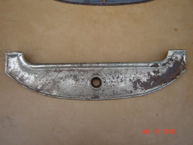

Continuing the discussion on radiator aprons-------
The first aprons, T-3977, were on the 1924 and 1925 models when Ford added the skirt on the front of the fenders.
Then in 1925, Ford offered an accessory nickel plated apron, T-3977-B, to go along with nickel plated radiator shells and headlight rims to dress up the 1925 models.
The apron for the 1926 and 1927 Fords with the nickel trim strip and the hole for putting a screw into the front motor mount/spring clamp is part #T-3977-C.
Because the 1926 and 1927 TT trucks continued to use the 1924-25 style front fenders, but started using the front motor mount with the screw hole, they added a corresponding hole in that first apron design, and that is T-3077-F, with factory #TT-8016.
Here are photos of the 1925 nickel plated T-3977-B,the 1926-27 T-3977-C with the nickel trim strip, and the apron for the 1926-27 TT trucks, T-3977-F.
