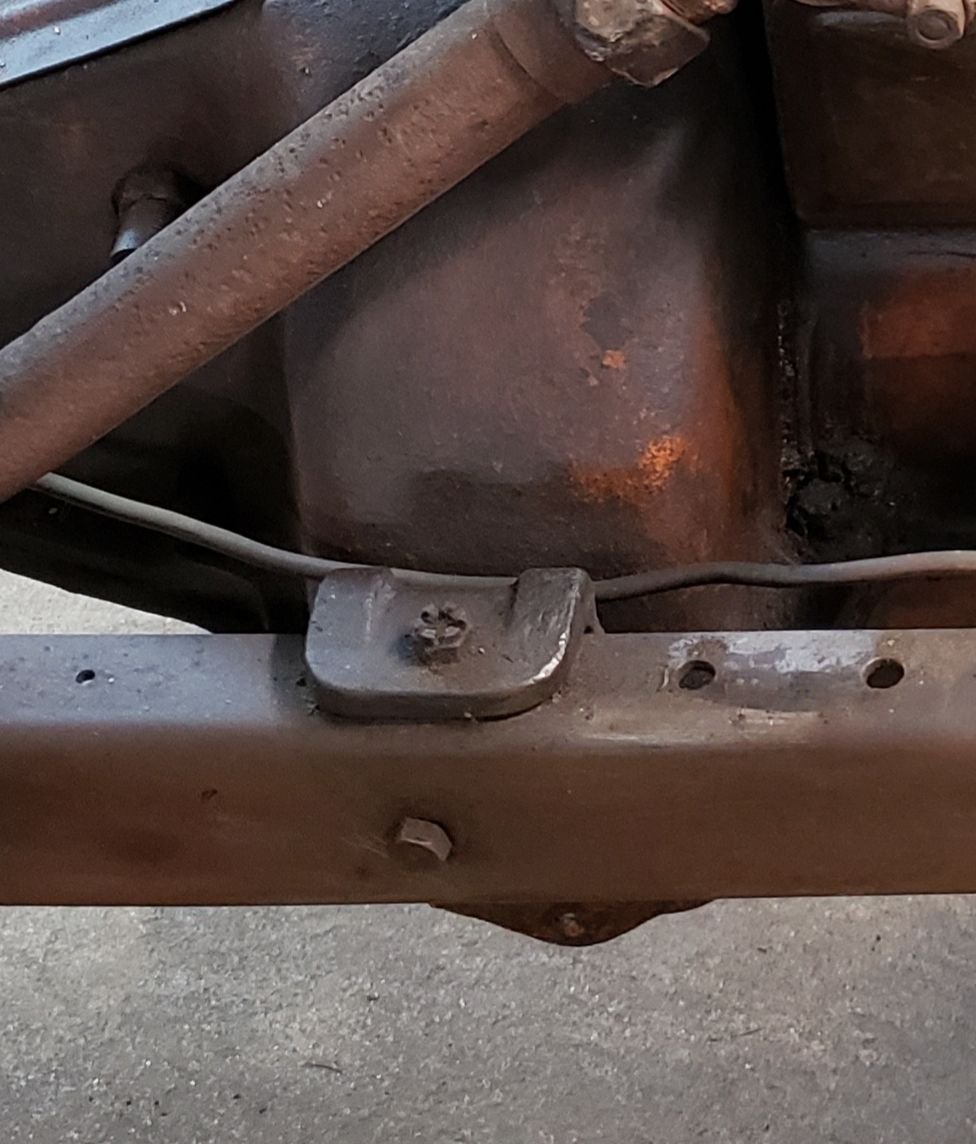

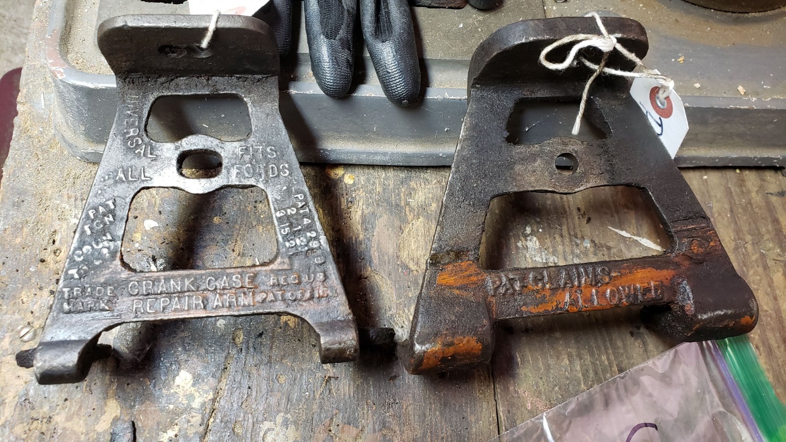

You could remove the cracked ears and then find some accessory repair brackets. My 1922 engine pan came with these. Pretty neat accessories that work well.

After I purchased Betsy, I noticed that the pan ear on the driver's side had a significant weld repair, so I purchased and installed a pan truss as extra insurance.
