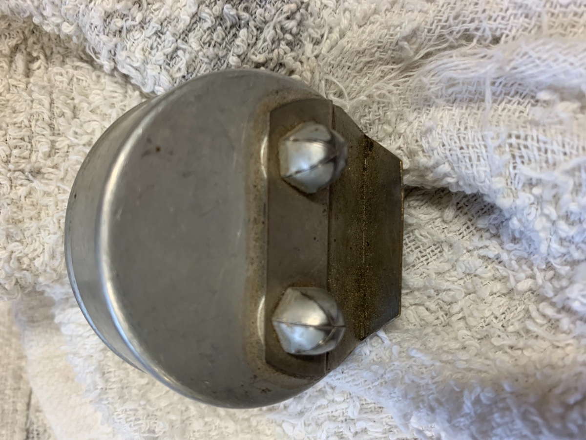

I have this generator current tester. I’m not sure if it’s for T’s or how to use it. Any ideas?

Had one similar some years back, easy to use, just put the back of it along any live wire or + battery cable and will read the amps in the circuit.

Thank you, I can’t wait to see the current draw when using the electric starter

If you use that to measure current draw, you still won't know how much current the starter pulls, and you'll destroy the meter, to boot. Even just spinning and not engaging the motor, the amperage will wildly exceed your meter's rating.

Agree with Scott on that, fine for checking the running amps but would fry it for cranking amps.

Thank you guys for saving my tool. I would never though the starter would draw over 50 amps

FYI...70 amps free running, 150-160 Amps cranking engine and 450 Amps stalled at 12 pounds of torque. A really good starter will push a little over 13 pounds, and will have even higher amperage, but 12 was the spec.

NAPA 700-1712 inductive couple starter ammeter. New $10.95 E-Bay free shipping.
Post by Novice » Wed Aug 28, 2019 4:13 pm
Tom. I have a old Sears inductive pickup ammeter # 2173 and it is great for checking starter current. Generator output and current draw from lights, Horn ect. NAPA sells one just like it model # 700-1712 there are 10 on E-Bay now brand new in the box for $10.95.free shipping. I ordered another one for a spare. Has two scales both zero center. 75- 0-75 & 400-0-400 amp just slips the over wire no physical connection. two slots one for small wire one for large starter cable.
