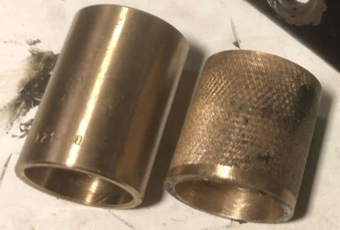

regarding the Bracket bushing
the inner size is correct, its longer but not blocking the greas canal, but the outer size is nog wide enough.
so it doesn,t fit.
if you make them by yourself, do you know what measure you take for this?

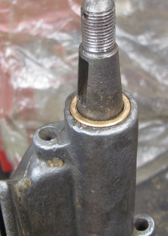

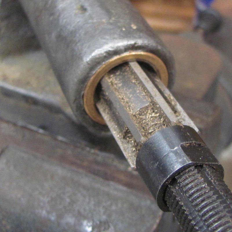

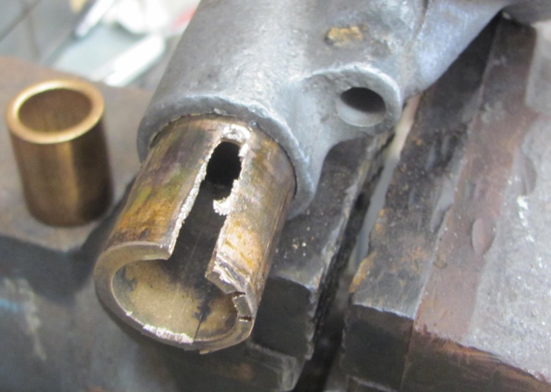

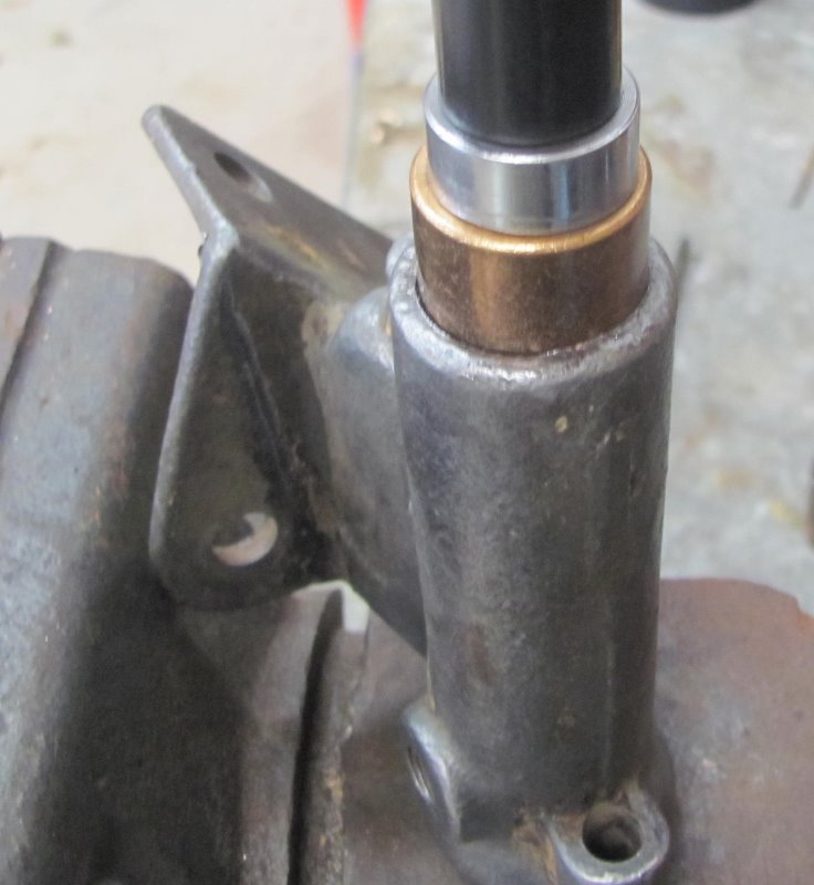

The bushing for the steering bracket is 1.0" (25.4mm) outside diameter.
The inside bore is approx. 0.754" (18.1mm) but that bore is then reamed to fit the steering shaft, that is approx. .750" when new, but the steering shaft will be worn at the bearing if you use the old shaft.
So the new bushing is reamed to make a smooth fit for the shaft.
If the bore of your steering bracket is larger than 25.4mm, then someone has machined it or the bore was worn oversize somehow.

Post by DanTreace » Wed Jan 23, 2019 5:23 pm
Bert
You are correct, my mistake, I gave you measures for '09-'25! Sorry!
I forgot to remember in answering that your's is a '26-'27!
Your '26-'27 bracket should have casting numbers T-932-C on the long side of the body. That is the factory number for p/n 3539D "Steering Gear Bracket assembly" 'Roadster, Touring, Coupe, and Tudor.' The Fordor is different for '26-27 and has casting number T-933.
The opening of the '26-'27 bracket is 7/8", smaller than the '25 and earlier.
Steering Bracket Bushing '26-'27 is p/n 3545B and measures 7/8" outside diameter, and has 3/4" (.750 bore) and is 1 1/4" long.
My photos and measure in my prior post are for the '25 and earlier steering bracket.

Dan,
Thanks i have that bracket you ment t932c
My inner size is a bit wider standard=7/8=22,22mm
And mine is 22,70mm
Maybe It is bored out ...
I had to make a new one I think..
Bert
