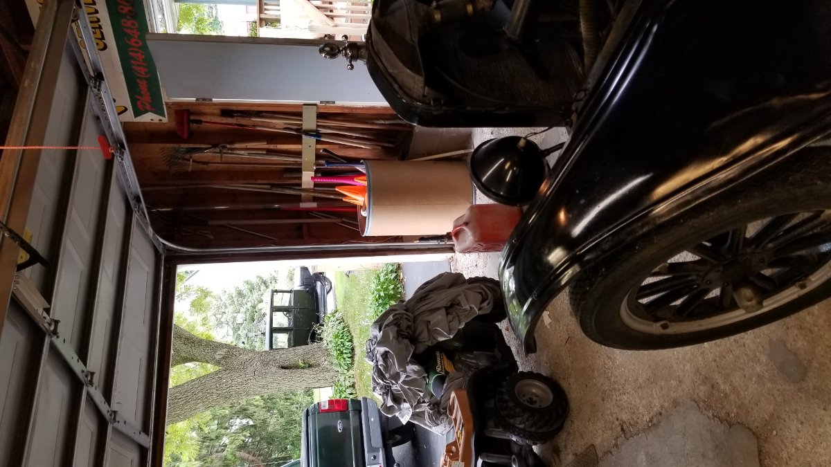

Picture of the poor thing looking at mine, just wanting to get out and cruise the open road.
