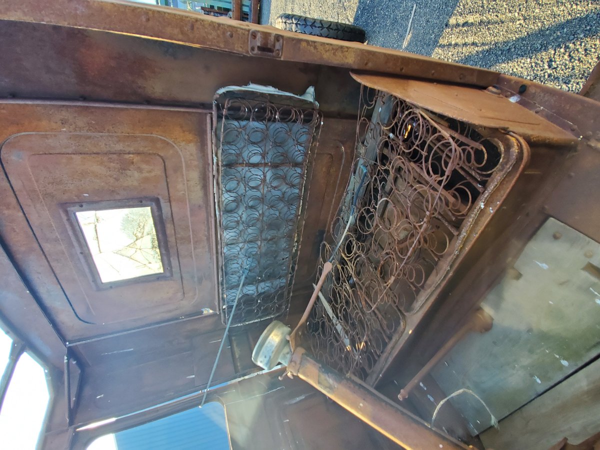

Good morning!
I recently acquired a Model TT and am trying to identify the year it was made. From the little information I've found on these trucks, it seems to be a 1925 or 1926? Where can I go to find more detailed change breakdowns for each year?
To be honest, I purchased this truck in a large lot of Model T parts and will be selling everything I don't need. Thank you for your time.

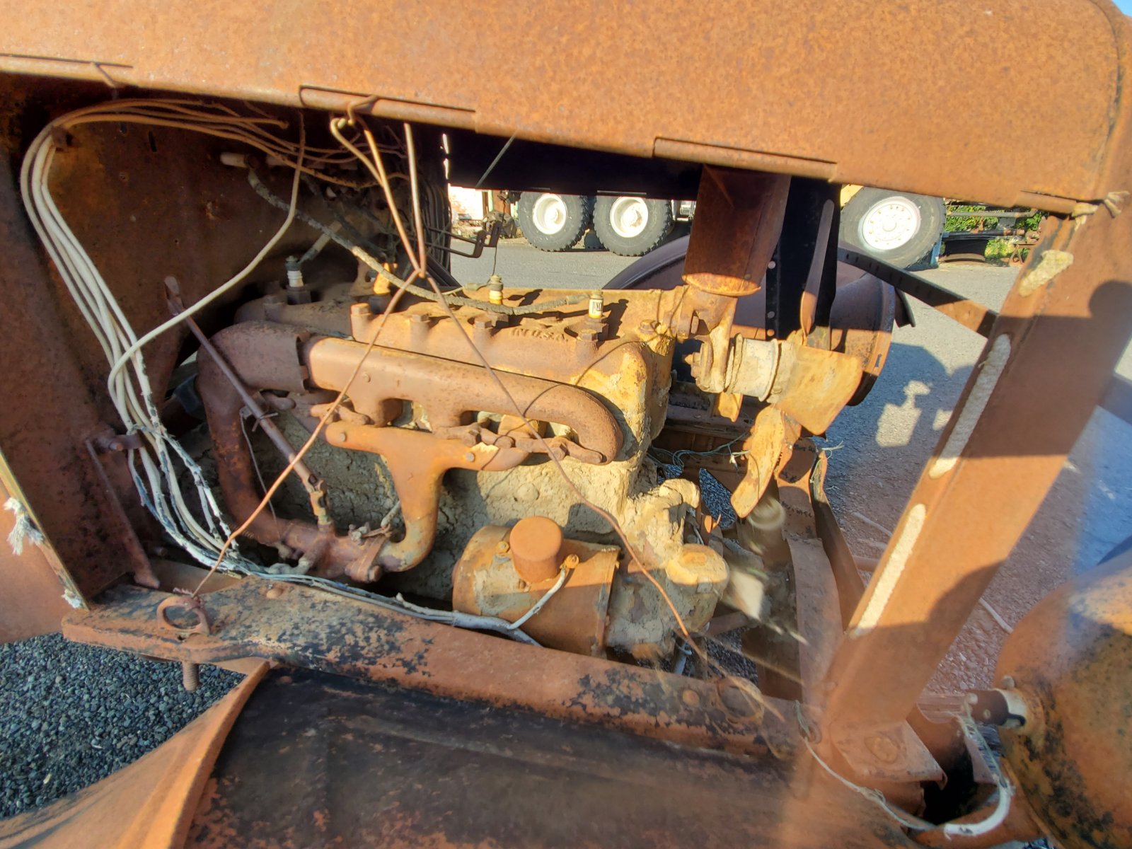

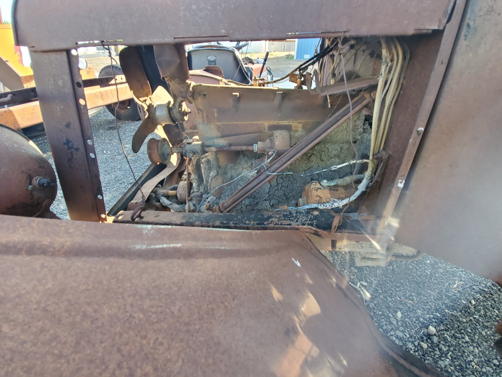

More pictures.

It’s somewhere between a late ‘25 (wide tranny pedals) and mid production year ‘27 ( (rectangular dash switch) .Engine serial number ??

I would say 25 if fenders are original. No lip for apron.

I see them now. Never mind.

Looks like 26-27 engine, but front axle looks 25 or earlier.

Interesting truck! Probably a '26. Auxiliary transmission, maybe an overdrive? Uncut rear end under a spliced/lengthened frame! Long truck with a couple nice accessories (including those brakes!). Well worth restoring.

I believe that trucks used 'old style' (1925) guards right through production. They did not use the updated car style fenders. Henry thought why waste the stock on hand for an old truck?

It is a late ‘26-‘27 cab. The windshield adjustment brackets are straight instead of angled like the earlier models.

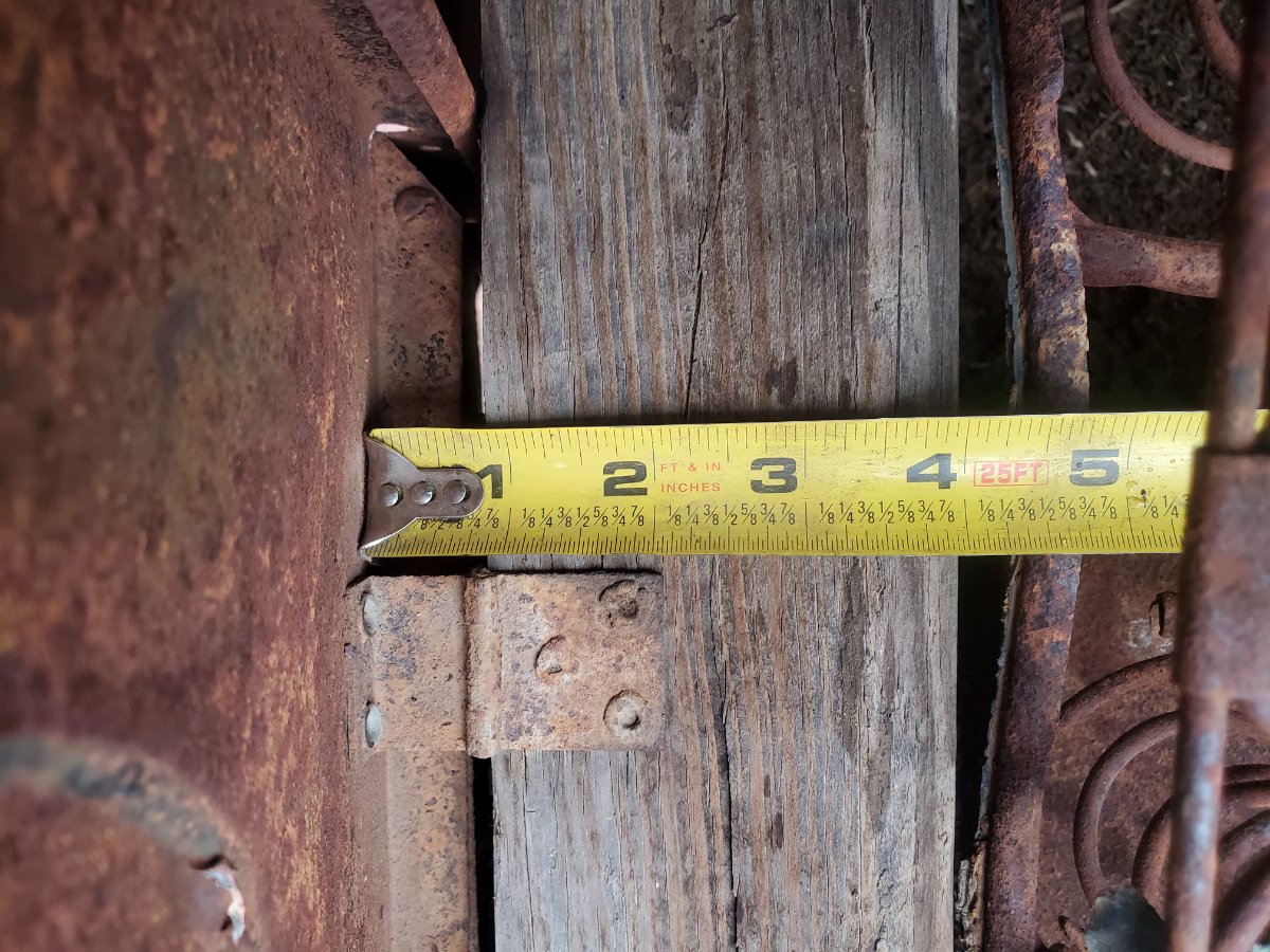

Posting measurements/pictures of the wood behind the seat of the TT for a member who emailed me.

Thank you for the pictures.

That board looks just like the one in my 26 TT. I posted measurements off of mine up here a month or so ago along with a diagram of it as well. The front edge is beveled. - Matt

Thanks Matt, my 26 TT is missing that board.
