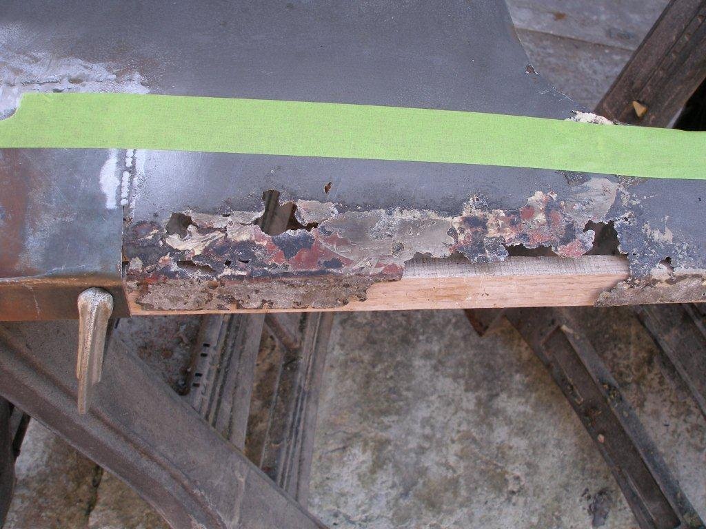

I bought a great little car which only needed new wood. After taking the ancient paint, bondo and fiberglass off, I had quite a project. At least with this one, you see what you're getting into...
From the one side view of the body in the post above, I believe that this is what that body's going to take to go back together; somthing along this line:

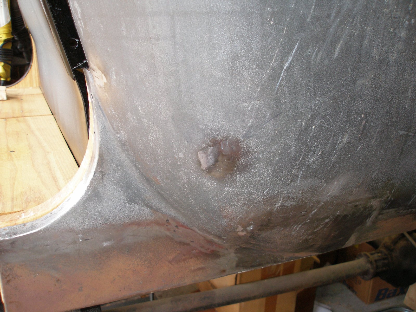

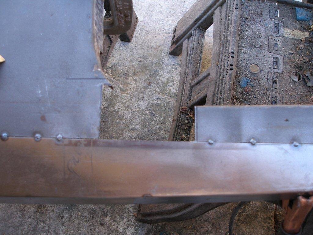

found a few more small pix...that panel nearly finished:

the driver's side was just as rotted and metal finished just fine...no bondo, just lots of hammer/dolly work and less hearing than I started with...
If you blow up the driver's side picture all the way, you can just barely make out the welds along the bottom 2-3 inches...

Wowzers Scott C! You did a fantastic job with that one! My '15 wasn't nearly so bad, but I still had to make a few somewhat smaller patch panels myself. I brazed mine in place because I don't have a wire-feed welder, and brazing distorts the surrounding sheet metal less than oxy/acetylene welding. I didn't have the time to finish as nicely as I would have wanted to. So a very small amount of Bondo was used. Less than a cupful on the whole body. I am quite happy with the results. Now if I can just find the time and dollars to get the thing onto the road!
