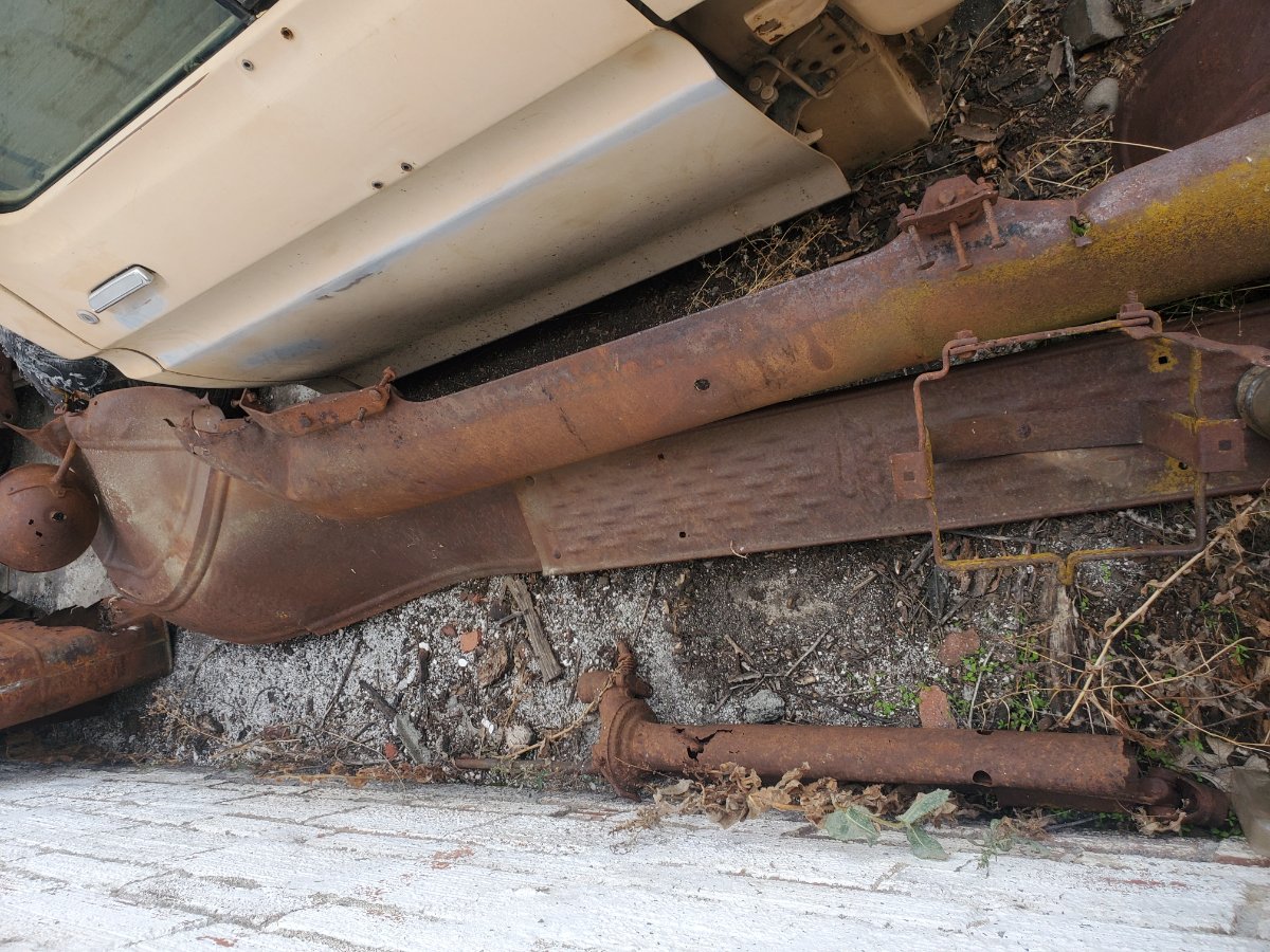

Fenders and running boards in question.

The fenders and side shields I cannot see the front edge well enough to be sure which era they are. The '24/'25 front fenders have a lower lip on the front to blend into the radiator splash apron used those two years. Fenders with no lower lip in front are basically the same from 1917 until late '23.

Here's a picture of the front of the previously mentioned fender.
I think I might have the frame, fenders, and splash shields for the 1913+ car. It had a wood firewall at one point.
