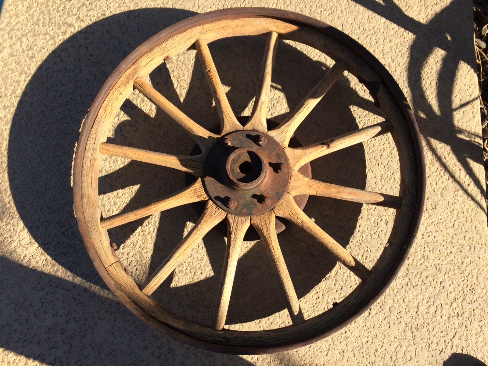

I need help identifying detachable and split rims and wheels.
I purchased a number of items including the stack of split rims:
Here is a rim with with two detachable rings:
This wheel has a hub larger than the Ford TT cap.  I am not sure if the hub Or woodwork goes with this rim.
Any help identifying these would be appreciated. They won’t do any good otherwise
At the very least I would like to know what to look for to find Ford split rims.

Matt,  I would need more detail to identify the rims and rings.  On the rims can you post the diameter on  the side with the groove and a picture of the cross section?  The rings appear to be some bead rings,  some wedge rings for demountable wheels and some are lock rings.  Again if you can give diameters and close up photos would help.   I would particularly like to know the inside diameter of the two rings that appear to be  blue and also a pic showing the opposite side.   Incidently  the rims are what was called quick detachable.  There were several brands but we need more detailed pics to determine brands

This one I have the wood in the hub inside. I don’t know if the wood or hub is original to the rim. (I actually have two of the rims.)
The sizes the same 25 inch diameter that takes a 32 x 3 1/2” tire. This is very similar to the above, but the grove is rounded on the bottom as opposed to triangle shape.

Matt,   the first one is standard universal earliest style with the back side rolled for clincher tire about 1909'1910   later S U rims used 2 bead rings.  You can tell these lock ring by the triangular groove and the tangthat fits in the hole in the groove.   EMF   used this rim 1n 1909 and maybe 1910.  Buick might have used this rim also on 1909 two cylinder cars.     The second one you show is Goodyear brand as you can see stamped on the rim.   I don't recognise the hub but Buick used this rim on 09 and 10 2 cylinder cars as well as the SU rim.   Reo used this rim on 08, 09 and 10 two cylinder cars.  It was used on other makes as well.   They came with  straight Side rings as well as clincher rings  the lock ring was flat with round edges to fit the grove in the rim and has a tang to fit the hole in the grove.    Are there any 25 inch bead rings,   perhaps the two that look blue Gray in the picture

Thanks for all the input on these split ring rims!  I understand: No Ford parts here.  Yet!  I am still going through the stack.  It looks like I will get an education!
As Wayne mentioned I don't have a set. The first style I have three rims, five rings, one split rim. The second style I have two rims one with a hub and spokes and perhaps the rings (not split) could be put on these. Steve, did I get my terminology strait?
So these seem to be in the 1908 to pre teen era.
