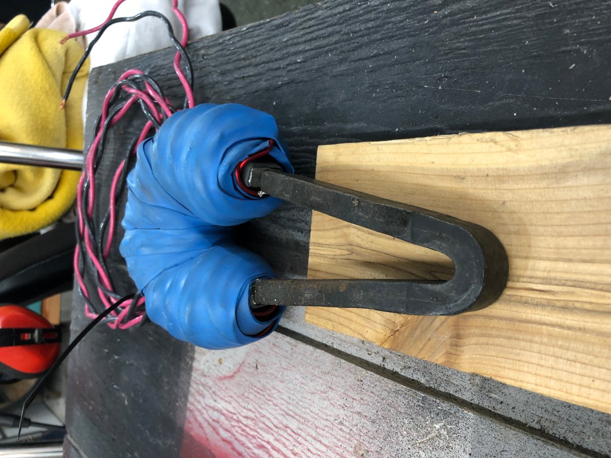

Re: Efficiency of Bar Type Magnet Re-Chargers
I like to take that a step further by having the bar recessed inside the coil a few inches so the magnet is both touching the bar and also has the coil around it.
I don't know if this is superior to other arrangements, but it charges the magnets enough to hold 4 to 4½ pounds.
