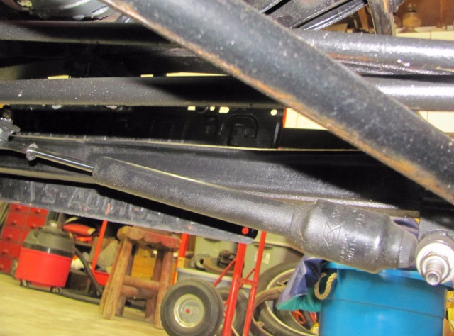

Today the modern version is the hydraulic shock, steering damper, which I like on my touring. Some frown on this accessory, but my wrists like it
p.s. The tie rod on my touring is solid bar stock, plenty stout to work with this modern damper.
