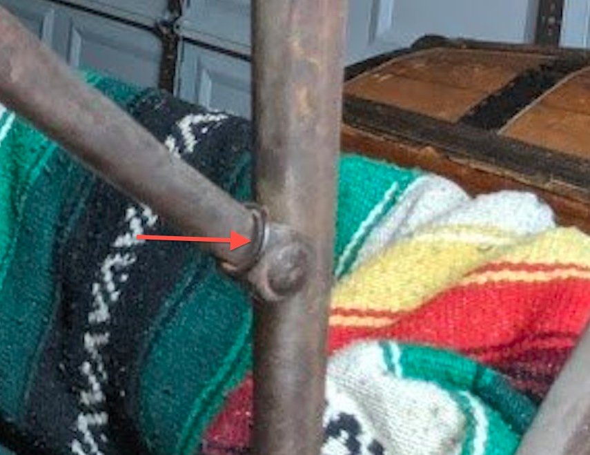

1918 through 1922 roadster tops have square sockets and do not utilize leather straps with t-head cotter pins, or "key straps" as R.V. Anderson called them.
Instead, they utilize these clips/pins which slide up and down the socket:
https://www.modeltford.com/item/3314CSB.aspx
I do see what appears to be the above clip in Mark Bailey's photos.
Note that with round sockets used through the 1917 model year, the pins on the bottom of the sockets face outward and enter the corresponding eyelet from the inside. Pins on the bottom of the 1918-22 square sockets face inward and enter the corresponding eyelet from the outside.
Hope what I wrote above makes sense to you.

I don't see the clip; your eyes must be better than mine.

Post by Erik Johnson » Fri Sep 27, 2019 11:08 am
Arrow pointing at clip....
