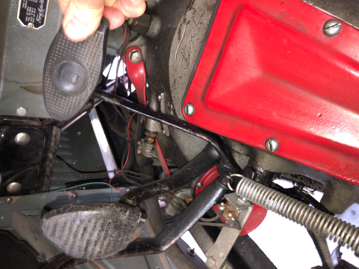

As long as you weld the tab on the brake pedal in lower correct spot the external brake shoes only need a small amount of pedal movement. Take advantage too if the rearmost position of the pedal cam, I use a large spring to keep the pedal rearward.
Then the first bit of travel operates the exterior rear shoes. And more pedal push begins closing the transmission brake band.
In these photos the rods to the exterior brakes aren’t mounted. And the pedal travel from zero, fully back in the cam, allows for 3” of pedal push until the trans band starts to close on the drum. More push locks the trans brake, so have that trans brake fitted a tad loose for this reason.
Photos are full size...iphone, so ‘click’ on the images and they will go right side up! Forum Thing on photos sometimes :roll:
