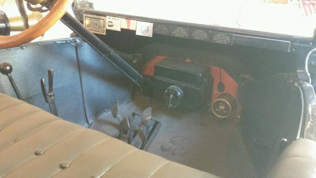

I looked at this car today. I am wondering what it may be worth. I was asked to make an offer. The car was built in the late 70s. 1916 # engine electric start Ruxstell rear end rocky mountain brakes?, McLaren wire wheels. Owner says runs and drives great. The car has been parked for several years. I did not hear it run or drive it. Just curious what it is worth?

Really depends on "mechanical" condition of engine/chassis & Ruckstell components - if all is in top condition I'm estimating easy $12 - 15K.
- Posts: 7350
Re: 1916 Model T Roadster Value ???
Dressed up with extra brass to look like a 1915. As Steve T says, it depends on the mechanical condition. I paid $8500 for my 1915 runabout, but it needed lots of fixing.

Although that car has a lot going for it such as the aftermarket wire wheels, be aware that the body is 1917 or later as the cowl has a notch in it.
It's possible that the car started life as a 1917 Ford and it has been dressed up to look like a 1915/16. Note that a block with a serial number from August through December 1916 would be in the 1917 model year.

This reply is to Eric Johnson. What are you describing notch in the cowl making it a 1917?
Thanks Mike
Thanks Mike
- Posts: 3743
- Last Name: Wrenn
Mike...look in the 2nd pic of the 2nd bunch..right above the coil box. I noticed it too and thought "uh-oh"..another one. I have seen other 15' s for sale with the same. Happens a bit.

The notch
