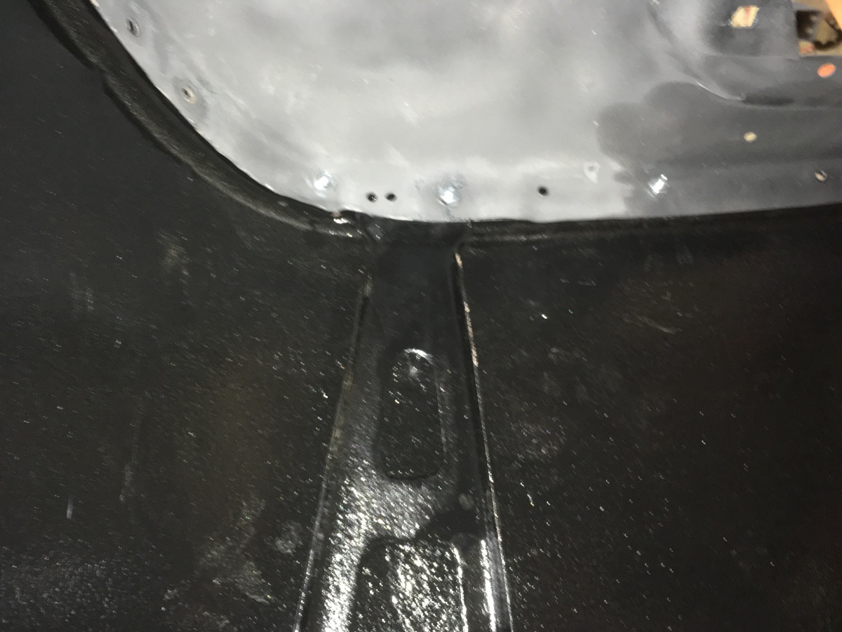

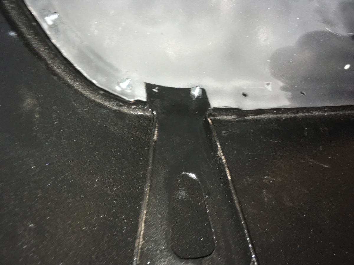

Pulled everything apart and blasted it, patch paneled and primed it and am now slapping it back together. Unfortunately, working with one good cowl and one good firewall that weren’t attached to good opposing pieces I didn’t notice or photograph whether the cowl bracket that extends up to the firewall goes BETWEEN the firewall and the cowl or inside of everything? It looks as though there is a indentation there in the firewall where it should go between...

I’ll attach a picture of both ways the cowl brace attached....which way is correct? The image is turned 90°....

Post by Mark Nunn » Mon Oct 14, 2019 10:23 pm
Rob, I went out and looked at my '26 Roadster and the brace is riveted on like your lower photo. It's not between the panels.
