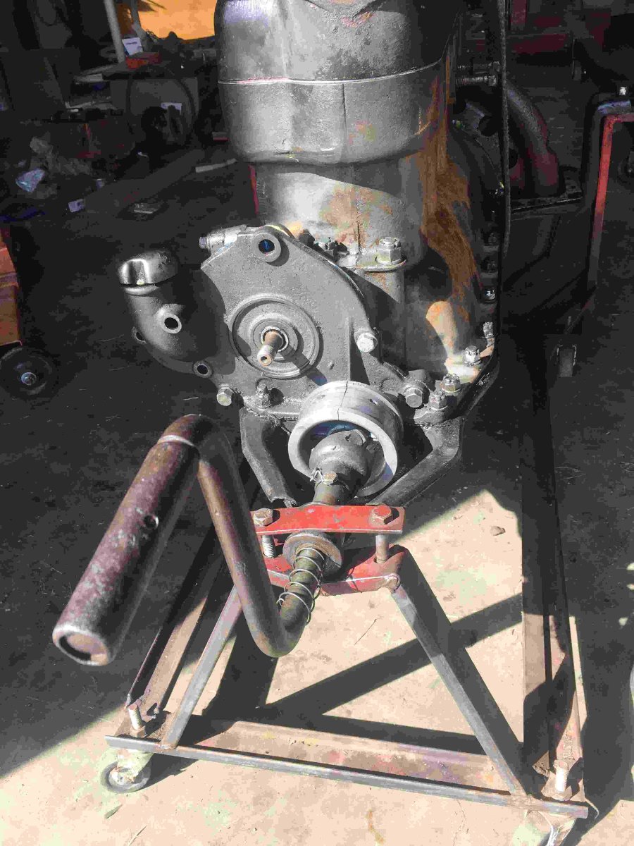

Here is the front of my engine. In the past I had to switch to an aluminum pulley as my crankshaft was galled and would no longer accept a stock pulley. I used to try shimming, soldering, brazing, or welding the inside diameter of a stock pulley but found all stop-gap measures purely temporary. The following mod. does not work well on a stock stamped steel pulley as it doesn't have a flange.

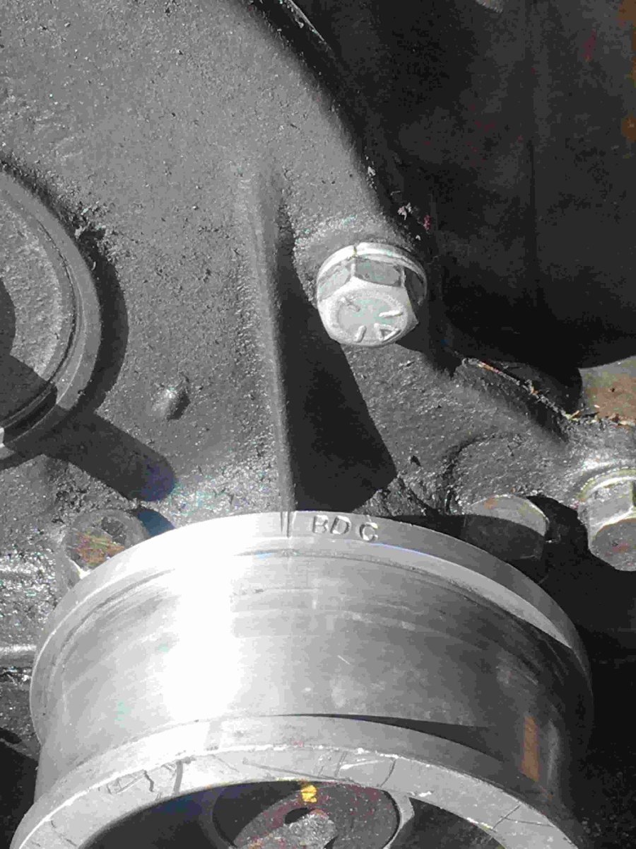

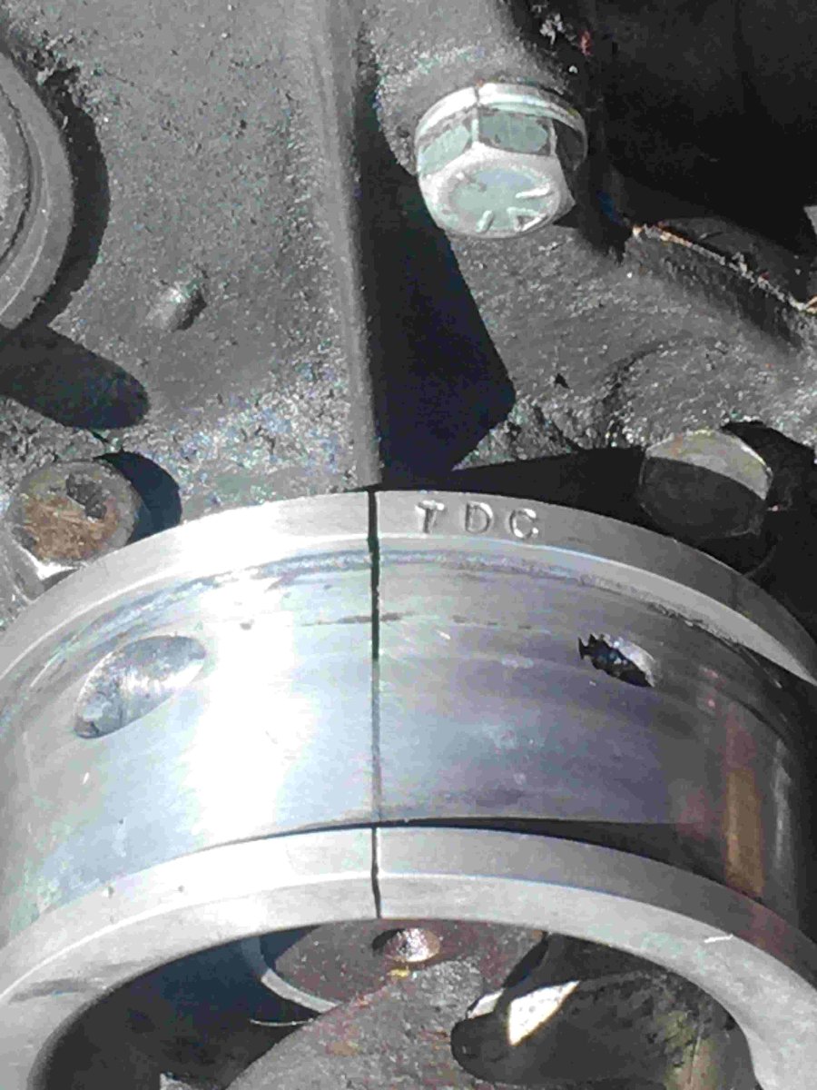

If you pull the engine through so that the crankshaft pin is horizontal you get either top dead center (TDC) or bottom dead center (BDC). Using a handy boss on the timing cover you can mark the pulley for later reference. It is very difficult to see the pin whilst the hand crank is engaged so this method is much easier.
BDC: TDC:
This has worked very well for me in the past, But I long to improve on this so tomorrow I will add the marking +15 degrees and a position mark to the left of TDC and BDC. This will facilitate more accuracy whilst utilizing Steve Jelf's timing instructions (http://dauntlessgeezer.com/DG97.html).

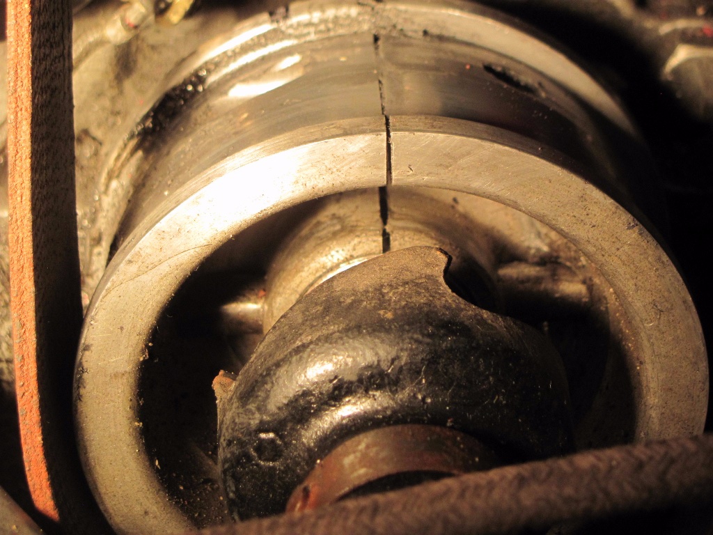

Seeing your post reminded me of last timer install. To set my timing using the handy lighted timing indicator tool from one of the vendors. Allows degree view of piston travel.
And.... those rimmed alum. pulleys from Dan Mc, the crank pulley pin goes straight thru those pulleys, and the split is right at the middle. So, when you place the pulley (really only one way as the set screw is best approached from above), the split is right on TDC!
But your idea to stamp the numerals on the rim of the pulley is just plain good idea
Alum pulley showing split at top, and crank pulley pin horizontal......TDC.
