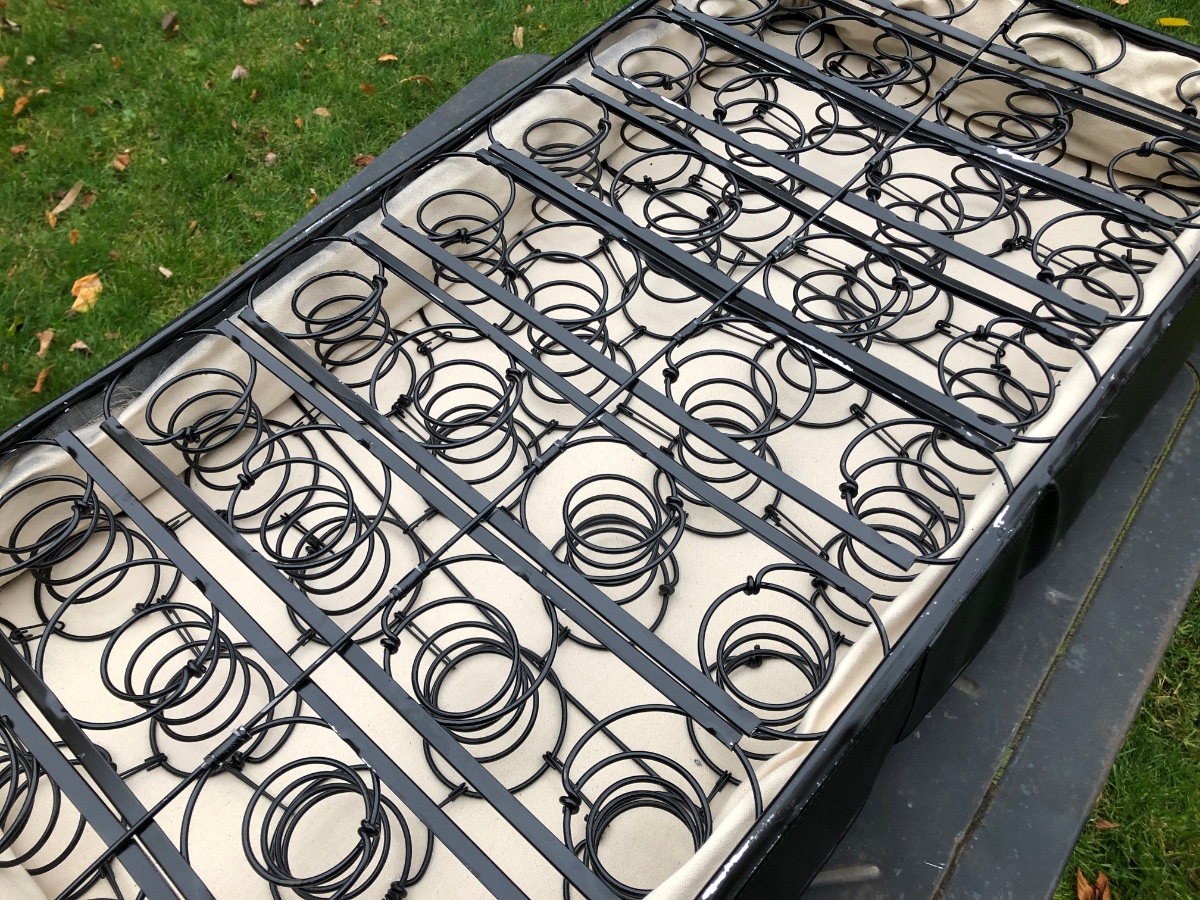

Finally got the seat cushion springs covered with the Classtique upholstery. i think it would have been easier with a second pair of hands. As it was it was a little like changing bands.
I found that I had to loosen the 2x4s and reposition the cushion a few times in order to get the crimping tool in where I needed it. Also used a thinner wider board under one of the 2x4s to extend the pressure without the added height to interfere with the crimping tool.
In the end it came out nicely and the next step is the back and sides. Thanks to Mike at Classtique and others for helpful suggestions. Any preference for filling tack holes prior to the next step? Toothpicks and glue or plastic wood?

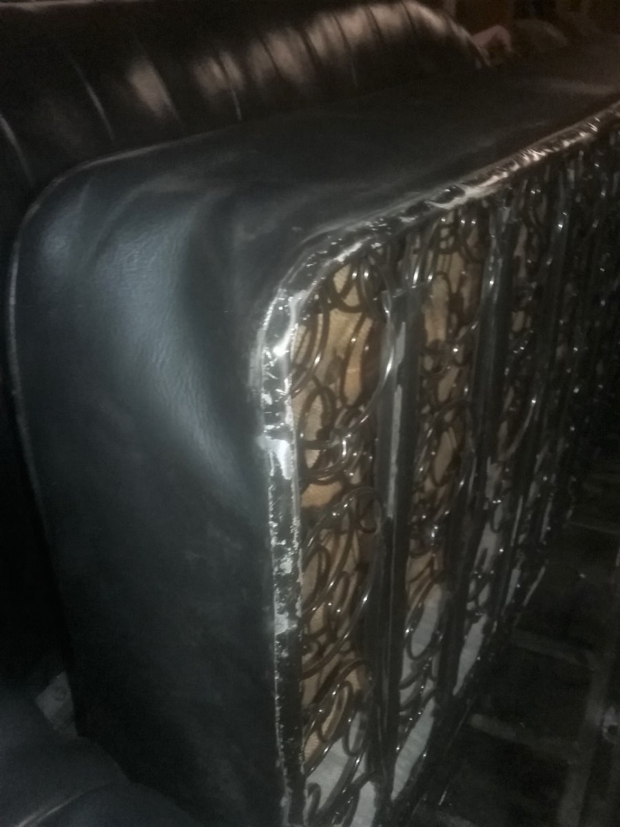

The old upholsterer in me would suggest Titebond III and toothpicks. If that was the original upholstery , it probably isn’t that bad, but it will keep weather out of tack holes that aren’t reused. Not sure they even make plastic wood still. I hope not.
I have a question on your third picture. Is that the finished underside of the seat, or before you put the padding and cover on?

The next step is the back and sides of the seat. I’ll be reaching out for help on that too. The people at Classtique are really great, but their installation instructions and videos really need to be revamped. I teach workshops in complex techniques of making photosensitive materials for photography. In these workshops I demonstrate the processes and everyone receives a manual with step by step instructions that make the complex easy. Google George Eastman Museum process videos for samplers with me describing everything from daguerreotype to gelatin emulsions and color photography. I can see a need for detailed instructions and videos in the upholstery culture.
If there is anyone out there who can walk me through the installation steps of the new back spring and upholstery I would really appreciate an email at mosterman@eastman.org I’ll make a tintype of your car in trade.

So why after all of you post's did you use hog rings? I don't get it!

I'm confused of what you did...
The sewn in cord at the bottom of the cushion should be crimped into the channel of the spring. The underside of the cushion should be visible through the springs from the underside. Late 1911 and through 1912 cars had the underside of the spring covered with cardboard and artificial leather. I believe for 1913 and on, they were open. Hog rings were never used.
Keith

Come on guy its obvious what he did, the canvas is hogringed to the top of the spring before you put the upholstery down around the spring, canvas holds the cotton from falling down into the spring then the spring is crimped to the upolstery

Yes the canvas (what Mike called “canvas burlap” for some reason) is there to prevent the cotton batting from falling apart and through the springs. The canvas is more effective than burlap. That canvas and the hog rings come with the kit. The stretched and secured canvas is then covered with cotton batting and then the upholstery is placed on top. The whole assembly is turned over and the sides pulled up. The edges of the sides are folded over a cord and sewn.
Then the fun begins as you compress the springs with two 2x4s and work the sewn edge of the cover into the channel and lightly crimp. Once you get all the edges of the upholstery into the channel you tighten the sewn in cord on the edges and follow by serious crimping of the metal channel.

I assume this is the reason why Classtique suggests using hog ring affixed canvas as the barrier between the cotton and springs. This is my original seat and you can see where the burlap worked its way through the coils. The stretched canvas would prevent this from happening over time.

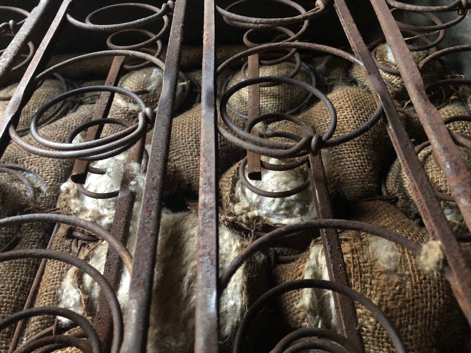

At the factory, the leatherette, batting and burlap were originally installed on the springs as one pre-assembled unit. Note that on the original upholstery, the split metal prongs of the buttons go through the cotton batting, burlap and round metal retainer/washer before they are bent over.
The above means only one operation and zero hog rings to install the upholstery on the spring frame vs three operations of individually installing the burlap, batting and then leatherette onto the spring frame.
Also, the burlap on the original upholstery only covers the top of the seat cushion frame. With the exception of perhaps some slight overhang along the top edge of the spring frame, the burlap does not cover the sides.

Here is the underside of my 1919 touring car front seat cushion. The Springs are from Snyder's. The Upholstery was from Carter's Cut 'n' Cover, about 30 years ago.
As Erik points out, the entire cushion assembly is assembled like the original. The top covering, padding, and cotton is stitched and tacked together with the double prong upholstery buttons. The burlap on the bottom sits onto the top side of the spring. I agree the burlap is pretty coarse. When I did the upholstery of my 1911 I used a duck type of canvas instead of burlap. The undersides of those cushions is covered with hardboard and artificial leather, so no one will ever know...
Here is the edge with the corded bead on the bottom end of the cushion crimped in the channel:
Again, these are Springs that I got from Snyder's and I believe the bottom edge is aluminum.
I hope the hog rings don't wear through your fabric. I noticed the corners on your springs look pretty square. Mine have rather square front corners, and the back corners, illustrated above, are more rounded.

I did the hog rings and canvas spring cover because that is how Mike at Classtique suggests installing their upholstery. The edges of the canvas are covered with cotton batting and then the cover assembly. So ... did the best I could with the most recommended supplier on this forum. Yes, it doesn’t show burlap when the seat is turned over, so I’ll fill my tank faster at the gas station to avoid people seeing that. 😄

There is no real interpretation of the installation. The cut and cord sewn edges of the cover determine the fit. The only thing that is not very trim is the excess canvas on the inside that is just pushed into the spring area where in the originals the burlap was trimmed much closer to the edges of the spring top.
