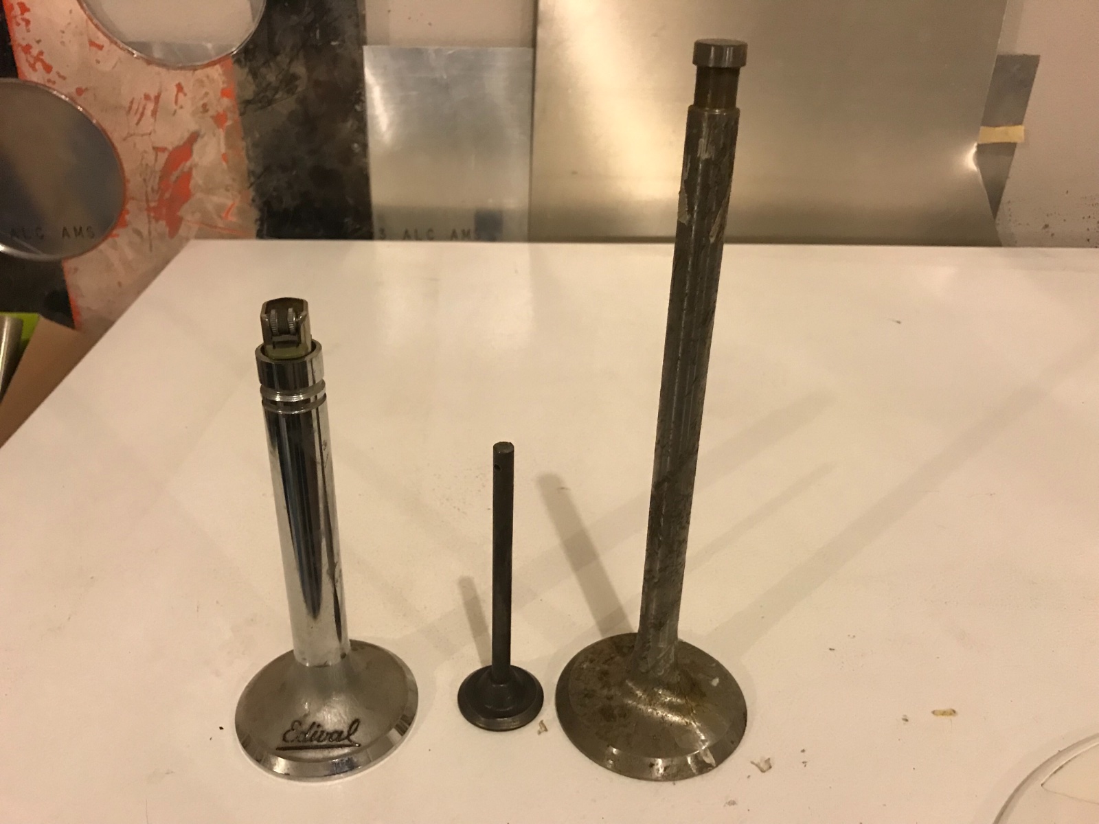

Well as long as we are talking about valves. These came with some model t parts. 🤷‍♂️ 😁
