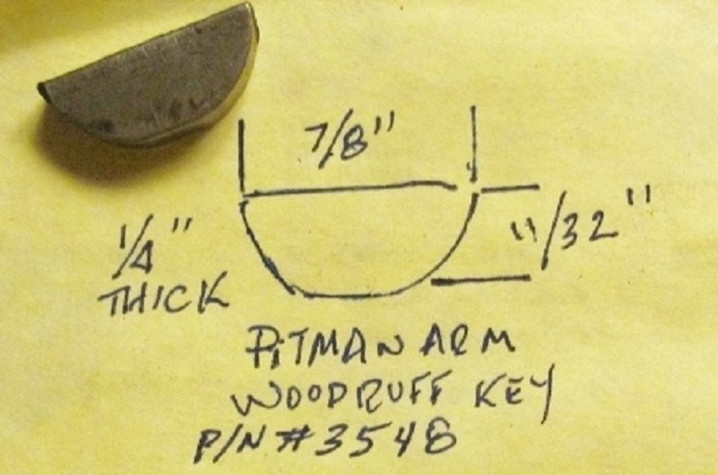

The problem is that Ford used a big key in a small diameter shaft. If you try to use a standard woodruff key, it sticks up too high and you cannot tighten the pitman arm on the steering shaft. The 'special' Ford woodruff key has been ground to reduce its height by flattening the rounded side. This allows the pitman arm to seat properly on the shaft....Don't ask me how I know..
Ron Dupree
Ron Dupree
Posts: 3949
Re: Mysterious Size of Woodruff Key for Steering Gear Ball Arm Part#3548 Question?
Post by DanTreace » Mon Jan 28, 2019 2:31 pm
Thanks Ron
Your important tip is correct.
Should have posted the sketch.
Many 'hardware store' replacements for Ford parts don't always fit or function like the actual part. :|

Wow! You guys have all been very helpful! Awesome sketch Don!
I plan to go to the hardware store and buy a 1/4" x 7/8". Then I will then grind it to size.
