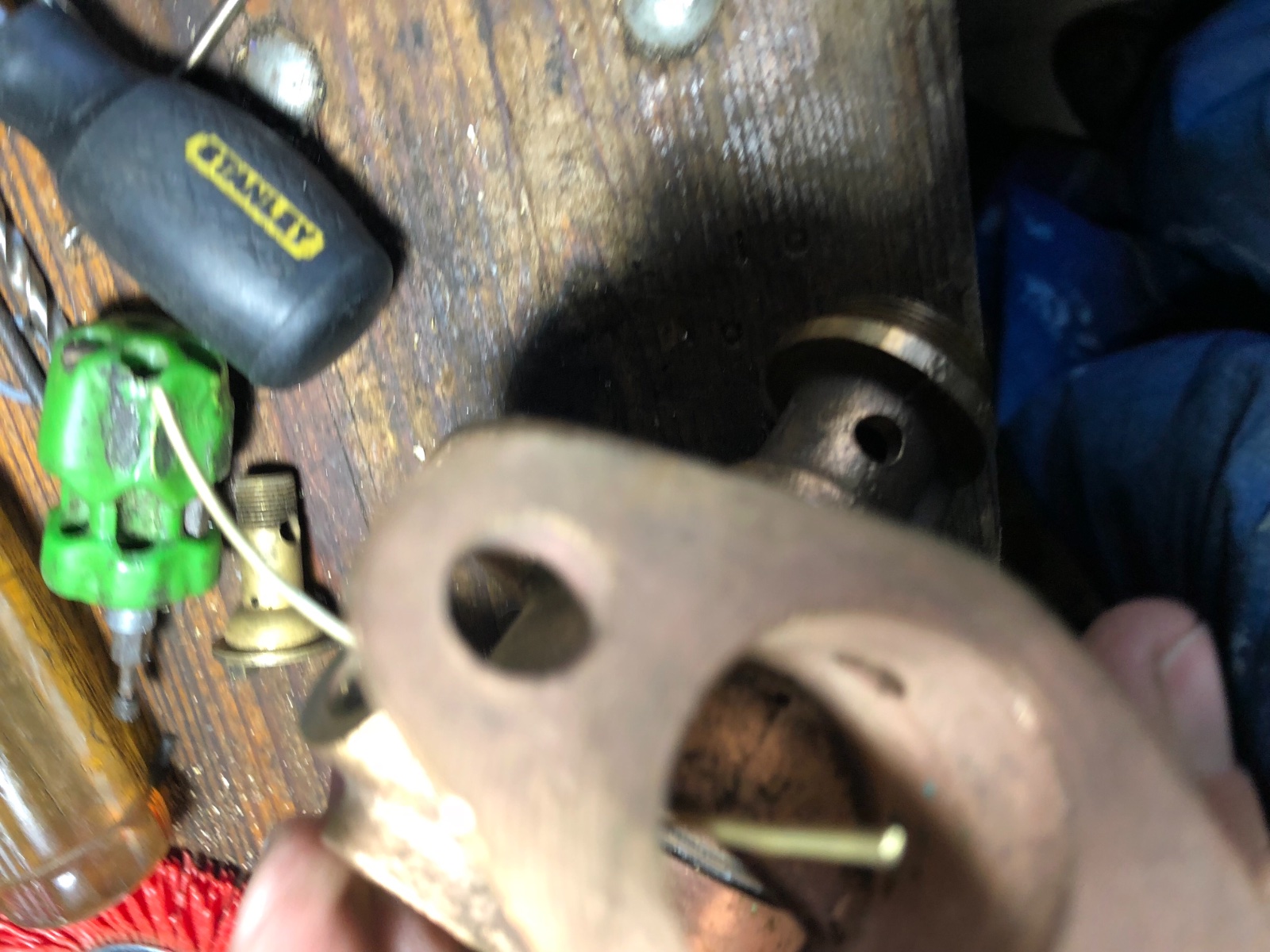

And I can't say I am impressed by the NH, but I don't really understand carburetion. Could you give your opinion on the three "secret passageways" that have to be cleaned? What are they for? How do they work? And does it make any sense to put plugs in the ends after cleaning to keep dirt out? It seems like that is just blocking up what you just cleaned.

Post by Tom Hicks » Sat Nov 09, 2019 1:02 am
The passages shown in this picture.
What do they do?
How do they do it?
Does sealing them up after cleaning them out defeat their purpose?
http://www.mtfca.com/discus/messages/80 ... 1253048587

Post by Corey Walker » Sat Nov 09, 2019 9:46 am
Those passages are for the gasoline to flow through at idle when the throttle butterfly is partially closed. Fuel is drawn from the mixing chamber and it flows through the passages until it exits inside the throat of the carburetor via the 2 holes. As the throttle is opened more air flows through the main bore and the venturi effect draws gasoline from the main puddle. The passage under the name tag is an air bleed to allow some air in when the choke is closed to replace the fuel being sucked through the oassages but it does not intersect them. The plugs were used to seal where the passages were drilled making the intersecting bores a passage from the mixing chamber to the throat.
Thanks, that is really interesting. Were these types of passages used on other brands of carburetors, or were they unique to the NH?

Post by Corey Walker » Sat Nov 09, 2019 12:44 pm
It was the same principle but required a lot more machining and parts. The G for example has a pick up tube that originates in the pool of gas in the depression of the jet then screws to a fitting allowing the gasoline to pass from the mixing chamber to a passage drilled to the carburetor throat. This passage is sealed with a screw. So it does the same thing but is more costly to produce.

Post by Corey Walker » Sat Nov 09, 2019 12:49 pm
The 1913 Holley S was similar but the pick up tube was soldered to the mixing chamber cover and the holes for the gas to flow were machined to line up for gas flow. The air bleed, which also served as an overflow drain, was a hole drilled from the bottom on both the G and S.
