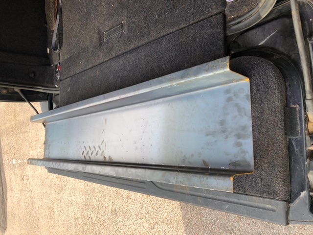

Re: The start of my TwinT project
I had a local fabrication shop fold up a 4’ long oil pan blank to use as a base to line up both engines and ordered 2 36 tooth1/2” pitch sprockets and a duplex chain for the wobble joint

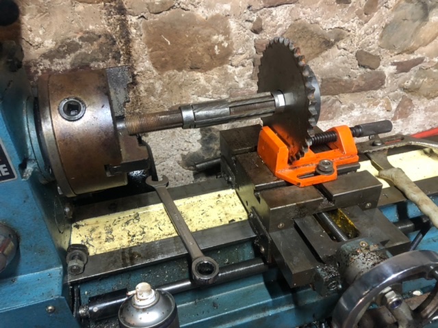

A couple of days home alone so i got on with doing the machine work to make the “wobble joint” .. two 36 tooth 1/2” pitch sprockets one bolted to the front motors output flange using 4 countersunk allen set screws (the nuts will be lockwired and the flywheel pegs used to keep it all together) rear motor gets a bossed sprocket with a coss pin going through the starter pin hole. I drilled out the boss to 1.125” then used an adjustable reamer to get a good interference fit. Just waiting for a long shank tap so i can thread the cross pin through but almost ready to put the two together and get on to the oil pan.

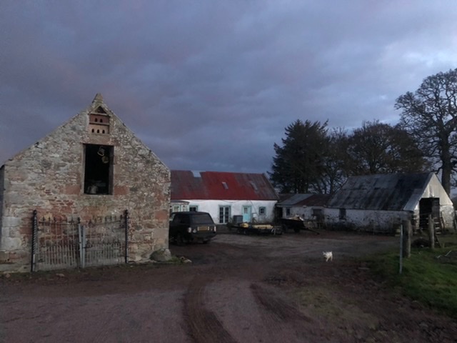

We bought the farm 5 years ago as a semi derelict cottage with two barns and 12 acres of overgrown grazing with some trees and a lot of broken fences. As we have 6 horses we wanted somewhere for them to stay that i could gradually restore into a retirement home for my wife and i that would have a workshop for her (a jeweller) and one for me ( a mechanical bodgineerwayne sheldon wrote: ↑Sat Nov 09, 2019 5:34 pmSteve P, Said " it might be bit intermittent as I am in the middle of renovating a 17th century farm cottage, the T's are a bit of a distraction!! "
Everybody needs distractions!
However, I would also love to see more photos of that farm cottage!
The cottage and one barn date from the 17th century and would originally have had a lower roof covered with turf, when i demolished the central chimney (as it was crumbling) i found turf imbedded in the stonework at the original pitch with moss perfectly preserved. It now has a corrugated tin roof that dates from 1912, i found newspaper from that date used to seal the underside of the attic floorboards to stop ash or dust falling through from above.
The farm is marked on General Roy’s military map of 1715. the redcoats were busy keeping us Scot’s subdued then too!

This morning

Oh I love those buildings. One can only imagine the history of a place like that! The T should be right at home there.
Thank you.
Thank you.

Yesterday i did the first rough cuts on the two scrappy oil pans that i have set aside for the project. The front one is a 26/27 four dip that had a rotten bondo patched flywheel housing so i felt no guilt in taking the grinder to it. The rear is an earlier 3 dip but the nose was a bit rusted so it got trimmed off leaving the dront seal bulkhead in place. I plan to use the folded steel tray to join the pans and create an oil reservoir for the front motor.

A little bit more tonight, oil dip pans removed and a little bit more trimming. The Ford pans should sit neatly within the folded tray once i trim the excess off then i can drill through the various holes to sandwich it together. The idea is to create a strengthened structure to support the two blocks.

Yesterday i had a short spell on the job, i finished tapping the cross pin to mount the sprocket on the nose of the rear motors crank, it will get a key cut in when i strip the motor to wash it all down (as it is backed with grease for storage) that let me bind the twio motors together for the first time.. i hope to get hold of one of Les’s floating trans shafts to help the long drive train balance issues
