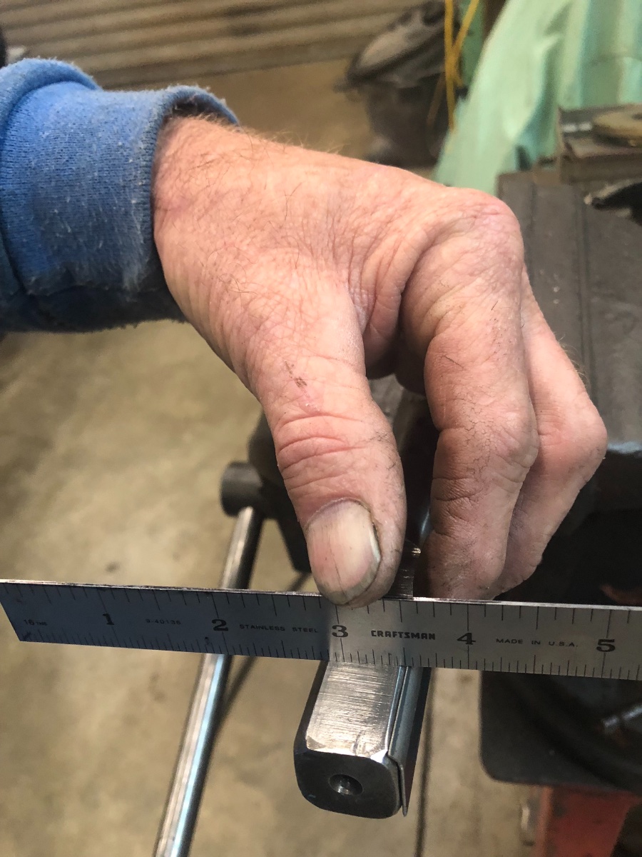

Well I was able to get started on this for you folks so here we go!
Here are the original dimensions we are going for. For our purposes, I am using a cut off driveshaft from a Warford mod.
You will also want to keep an eye out for 1 1/4" commercial banding strap as it is .030" vs 3/4" is normally .020".

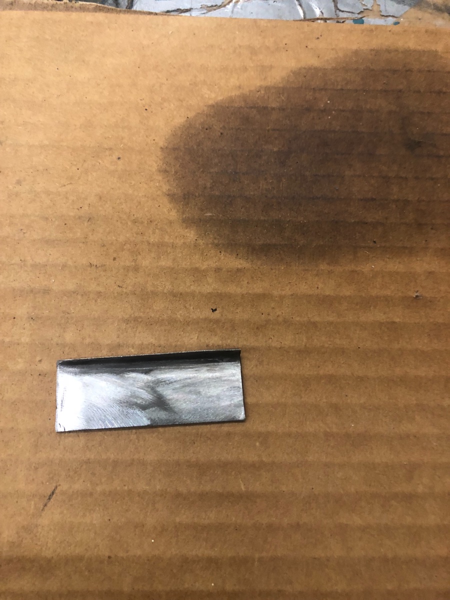

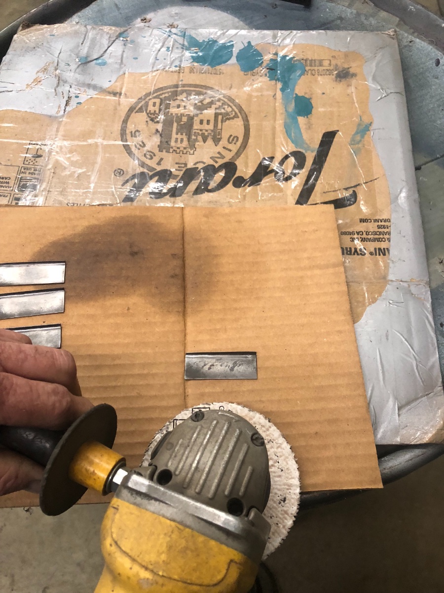

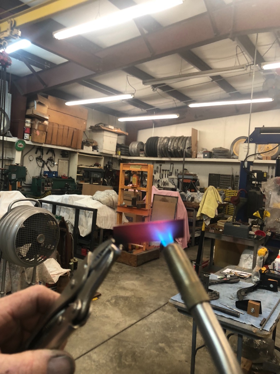

After selecting the high carbon steel strap material, slightly cut it a little oversize. Clean the metal by hand sanding first. You must anneal the metal prior to shaping and final cuts. You do this by heating the metal cherry red and letting it cool down at room temperature.

Now we can layout, form for the fitting. If you do not have a sheetmetal break, just use a vise with sharp edges on the jaws. I start with an 1/8" bending the metal a little less than a 45 degree angle. After getting the first angle, scribe the metal to be cut flush with the outside edge.

Cutting is a snap when the metal has no temperament to it. I next start fitting using a belt sander, first at the slightly bent edge. You want this to be flush or less than the side interception angle.

After all are to a nice fit and edges cleaned, time to re-hardened the shims. Quit simple, reverse as we annealed except we quench in water. Afterwards, I clean with a high speed paddle sanding disc and a little hand sanding.
