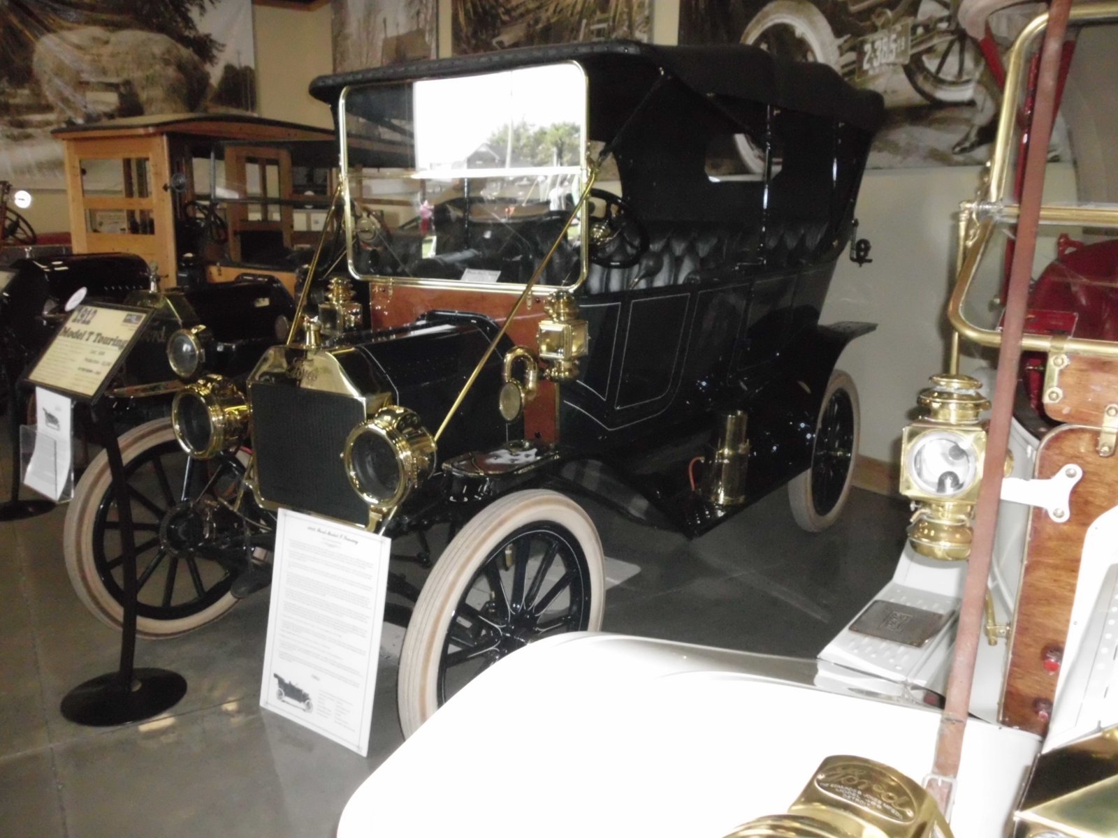

These stripes were copied from early photos. I did find considerable variation for the wheel stripes. Some have dual fellow stripes, some just one stripe. Got a photo of HF sitting in a 12 Touring that has elaborate wheel striping on both sides of the wheels. One configuration commonly seen for hoods is where the hood panels are individually perimeter striped. I have yet to see an early photo of

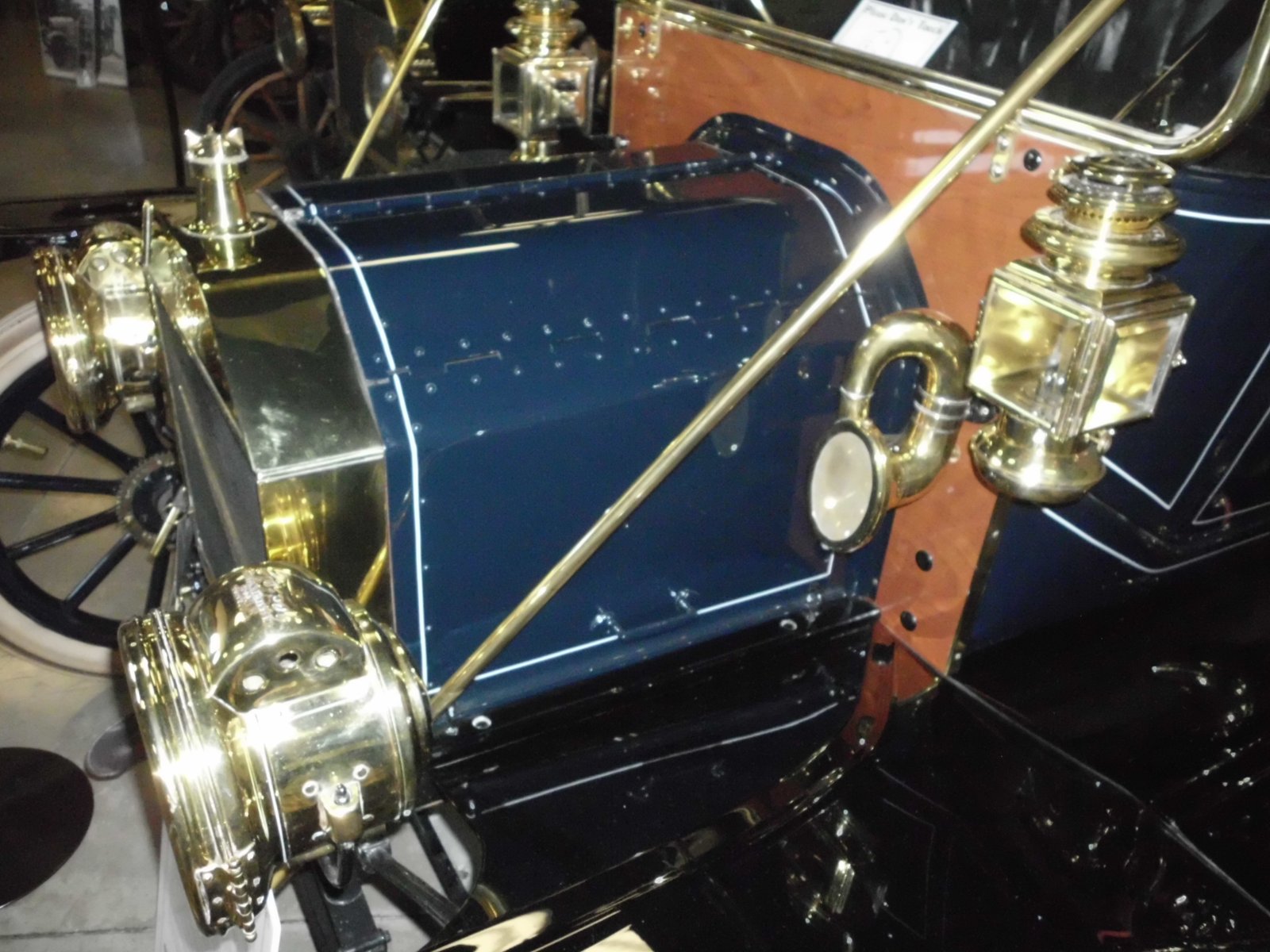

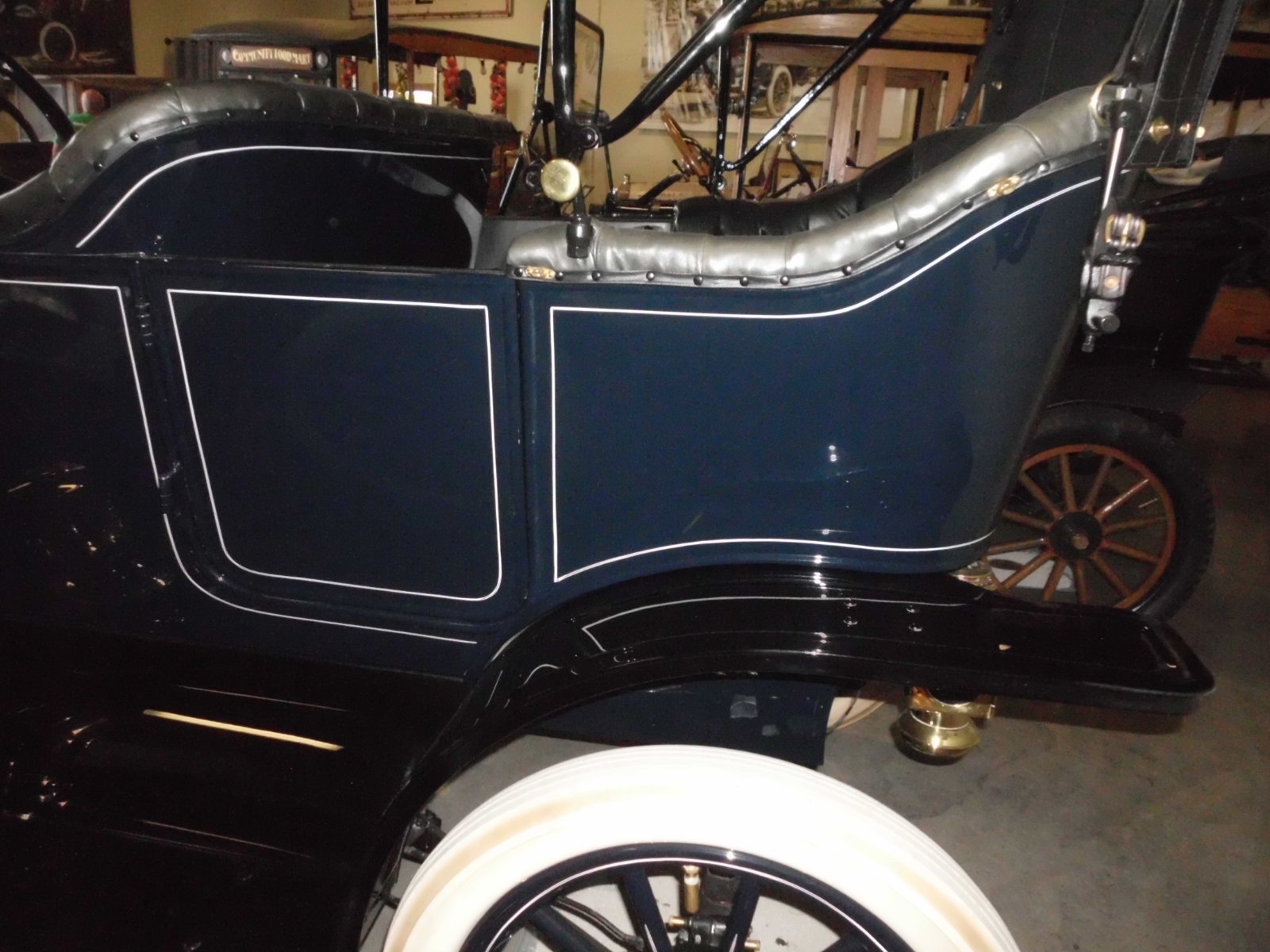

Scotts car is awesome and pictures do not show how nice it is in person. Every stripe on his car looks like what is posted in old pictures from back in the day to me. We all know that more than one person did the stripes so they would vary by car and who ever did the work that day so who can say what was right or wrong? Compare the picture posted just in this thread and I think you will say what Scott has done is about as close as anyone can get to correct. Here are some close up shots of the car I took last year.

Thanks for the kind comments Bob. A variable of striping seldom discussed is line weight (thickness of the stripe) Looks like common width is around .09", but there are those where the line is less than .06". My 09 has this original striping,where the thinner line work is an exceptional free-hand example.
I know this car in Moline Frank, and it is an exceptional professional restoration. The 2 tone pinstripes are not likely OEM correct, but this does not detract from this Touring's WOW factor.
