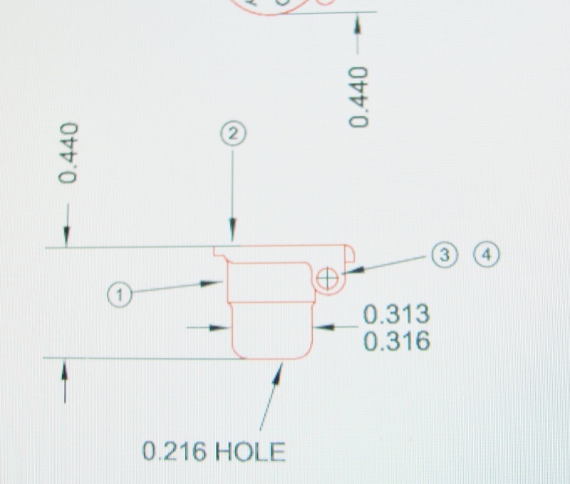

- Posts: 4089
Re: Installing Oilers
Wood dowel or a metal punch just under the i.d. of the oiler so it fits to the curved inside base, but won't protrude.
Picture sketch is the small oiler, usually the harder ones to install.
So first it helps to drill into the shackle hole a short way with a 5/16" dill bit. That clears the hole so the oiler can be driven in.
