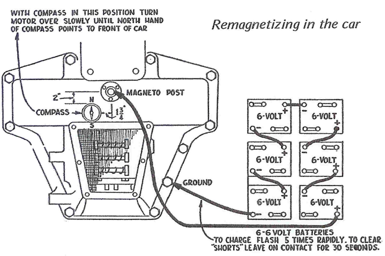

I would like to recharge magnets in car without removing transmission and I found This diagram on MTFCA Forum. In the lower right corner, it says to leave the current on for 30 seconds to "clear shorts". Isn't this a little long and could it possibly create shorts where none existed before? I have always heard that short bursts of current will do the trick and that leaving the current on for too long might damage or even burn up the coil.
Also did someone already experienced this method with successs ? Please feel free to share any tips or experience.

I have done it with both batteries and the KR Wilson re-charger. Before you attempt it, point the car east/west and check to see if the compass will indicated north/south when you crank it over with it in position shown. Pointing it E/W will show that you are reading the magnets not the earths N/S. Forget about the burning out of shorts and just stick with a few short burst at each of the 4 points.
You are looking for about 36+ volts DC, so 6 6 volt or 3 12 volt batteries will work. I just re-charge mine on using the KR Wilson unit. I had tried using a DC welder but had issues doing so and had no reading with the compass or very little after. I took it to the shop and pointed her E/W, pulled the plugs & put in neutral, got it as close to where is should be re N/S and gave it a couple of good jolts. The magnets got pulled into place by the winding's when current was applied on the first try and was able to proceed after that to re-charge in the other 3 sections. In any case, do take the plugs out and put in neutral, this will allow the engine to turn and center the magnets over the windings.
While it may not be the best way, it works. I have re-charged them and was able to hand crank start on magneto starting with a set that had very little charge left in them.
Oh other thing, do not put the batteries right next to where you are working, have them some distance away. When I do it, I cover them with a piece of plywood in case they blow up.

Recharging the magnets in the car does work well, but if your magneto has not been rebuilt you would do well to replace the field coils, the aluminum spacers and brass screws. Otherwise there is no guarantee that your mag is going to be fully reliable

I read somewhere that the 1 3/4" dimension should be to the center of the compass, not to the side of it. That eliminates differences between large and small compasses. Is that correct or would the way shown be good enough that the first jolt aligns magnets as Mark described.

I have had best results with hogs head off and charging each magnet individually. I tried to charge a weak magneto using the in car version on a '21 and made it worse. I suspect that the insulation was bad and one of the coils grounded out so actually less output rather than more. Anyway the car runs on battery but has a knock and will probably end up rebuilding the engine at which time will replace the magneto ring.

Has anybody tried this with 2 12volt batteries? I know that Fahnstock used six 6 volt batteries but could you use 2 12 volt batteries to achieve close or the same affect? Just wondering.

It's not really about the volts but Amps. Ford recommended at least 80 Amps, 6x6v to get the amps up there, that's why some arc welders would do the job and by today's battery AH's 2 heavy truck 12v could have the same resault.
The only problem I've come across in rebuilds is that I've found a few coil rings cracked at the bolting at the block, if from in-car charging I'm only speculating.

- Do not leave the connection for 30 seconds but just flash it a few times (5 or 6).
30 seconds risk to give you a result on the coils as shown in the photos. After the coil ring needed a total rebuild.
- Do not use the magneto post to do the charge. Use a screwdriver to make the connection with the coil ring connection spot. Take out the magneto post and use a screwdriver to make the connection. Insulate the screwdriver just behind the point as far that you can't touch the transmission cover and connect the + battery on the top of the screwdriver just under the handle.
- Flash with the negative connection.
- Open the transmission control cover and watch the end of the brass screws. Two should be parallel with the upper side of the cover, then the magnets should be in line with the coils.
