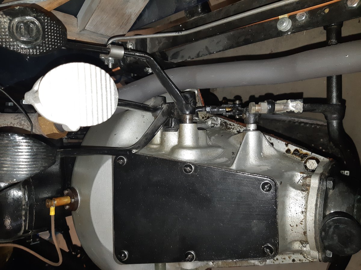

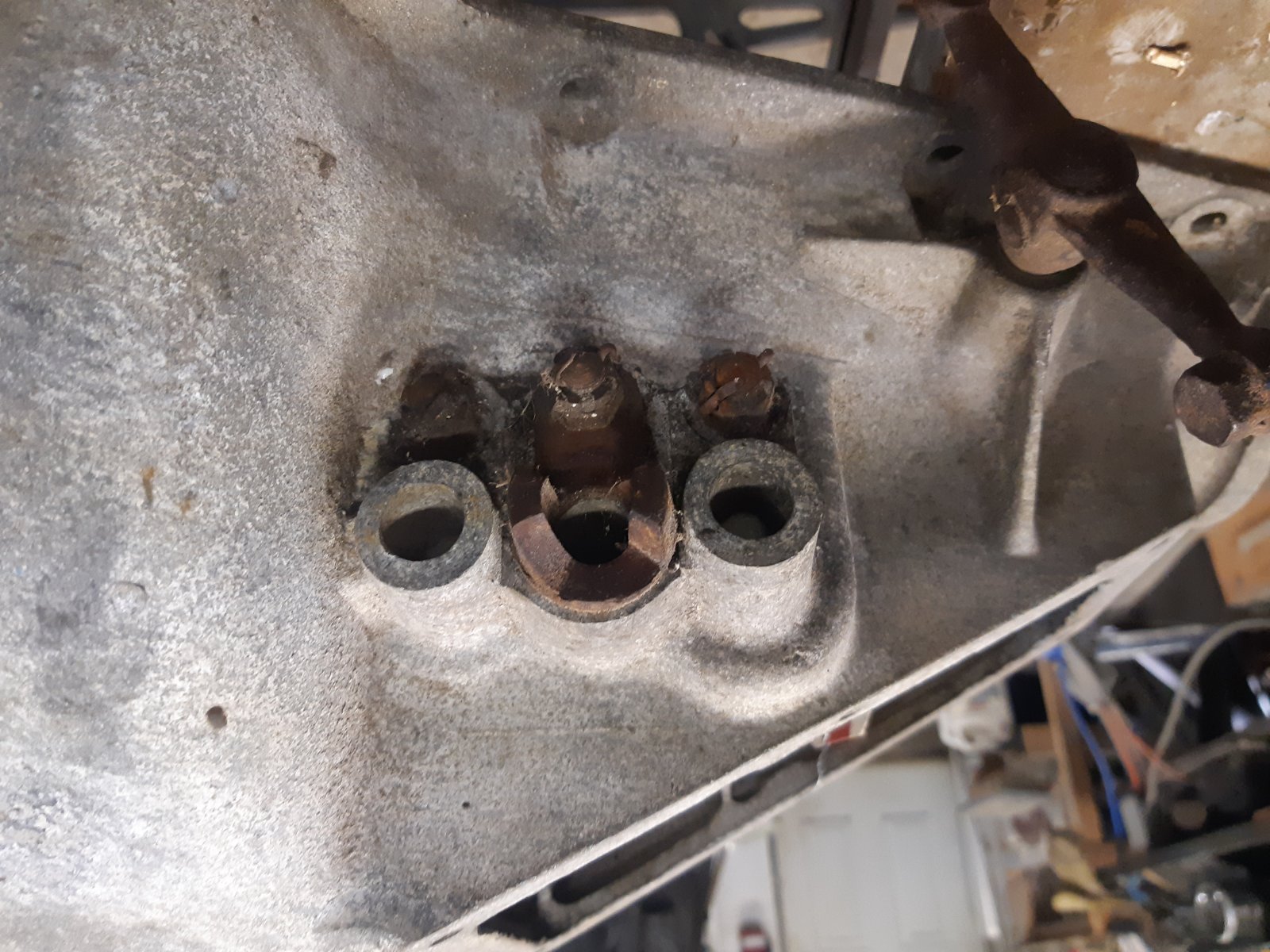

Here are some pictures of RHD hogs head assemblies. These ones are the earlier aluminum version for 14-15, but the basics are similar for all of them.
When you look close at the RHD differences, it looks like RHD design was an afterthought. The RHD parts are jammed in and prone to problems. The clutch pedal will hit the hogs head if bent even a bit to the left and the brake pedal will hit the exhaust pipe if the pipe is a standard shape and not modified for extra clearance. The shape and bends on the pedals are more awkward for RHD and are easily bent out of shape when heavy feet are used.
As already mentioned, the direction of the rotation of the transmission drums is the same in both LHD and RHD, the transmission gears, drums and other guts are the same for both. The direction of the reaction torque from contacting the bands is the same for both. So in the RHD, pedals all move in the SAME direction (left or right) the LHD ones and the reaction torque is applied to the opposing part. Look close at the pedal shaft cams and you can see how for example the reverse pedal shaft moves to the right in both cases. For LHD right is into the hogs head, for RHD right is out of the hogs head.The results in same side of the band being "pushed in" in both cases. For LHD right is into the hogs head, for RHD right is out of the hogs head.The same left side of the reverse band is "pushed in" in both cases.

Ran out of pictures space. Here is the '15 RHD pedal set up.

Kerry please study Jeff’s pictures. Yes the brake is used in reverse, but far less than forwards

Luxford, please look again at the picture of the pedals and a bit closer. Only the clutch shaft moves to the right on the RHD, both the reverse and the brake shafts move to the left when the pedal is pushed. I think its the same as the LHD.
The band ear that is "pushed" by the pedal action and the ear that is "anchored" against the solid casting (or adjustable screw) is the same for both RHD and LHD. The movement action on the band is the same in both cases. However the shaft moving in or out of the hogs head is what is reversed.
On the RHD when the clutch pedal is pushed down, the shaft moves out of the hogs head, ie. moves right. The same way as the LHD which moves into the hogs head when pushed and still moves right.

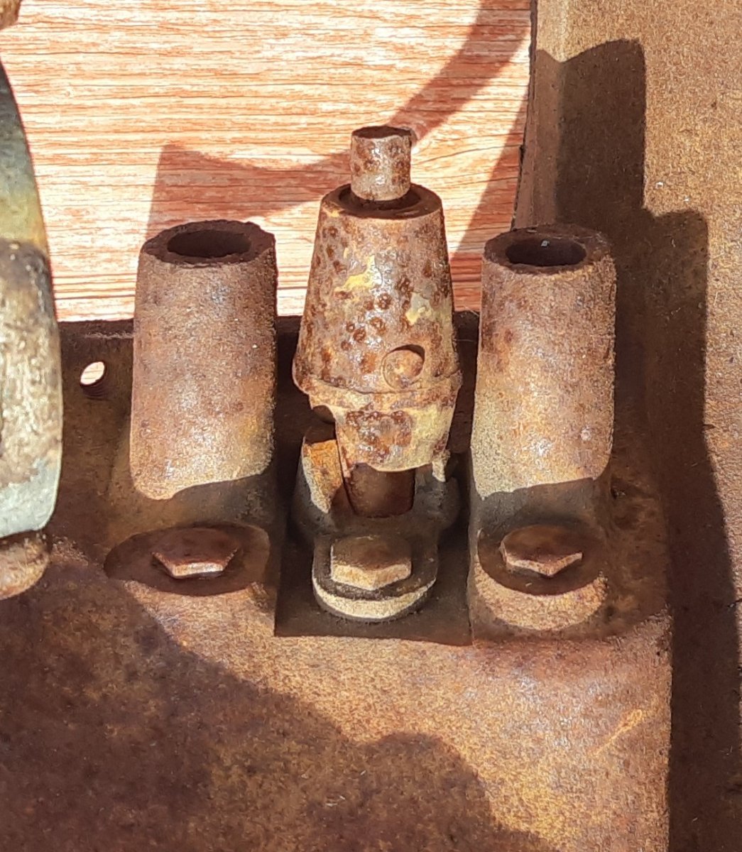

Here are pictures of the two different clutch cams. The rusty one in a cast head is a LHD, the one in the aluminum head is a RHD. Take a close look.
And yes, the pedal shafts are different lengths for the RHD as are the pin holes.
